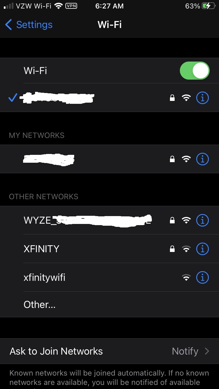

Does your android phone let you see the strength of the WYZE signal? This is from my iPhone, I erased all the numbers just to be safe :upside_down_face:Signal
The red peak looks to be the base station. I’m assuming your network is the largest peak on channel 6? If so it doesn’t look too bad and may not be an interference issue.
sorry, neither the tall red one or the tall light blue are me. mine is the one that says xfinity
I see at least 3 peaks labeled xfinity. I’m fairly certain the tall red one is your base station signal. I can’t see the label on the tall blue one.
