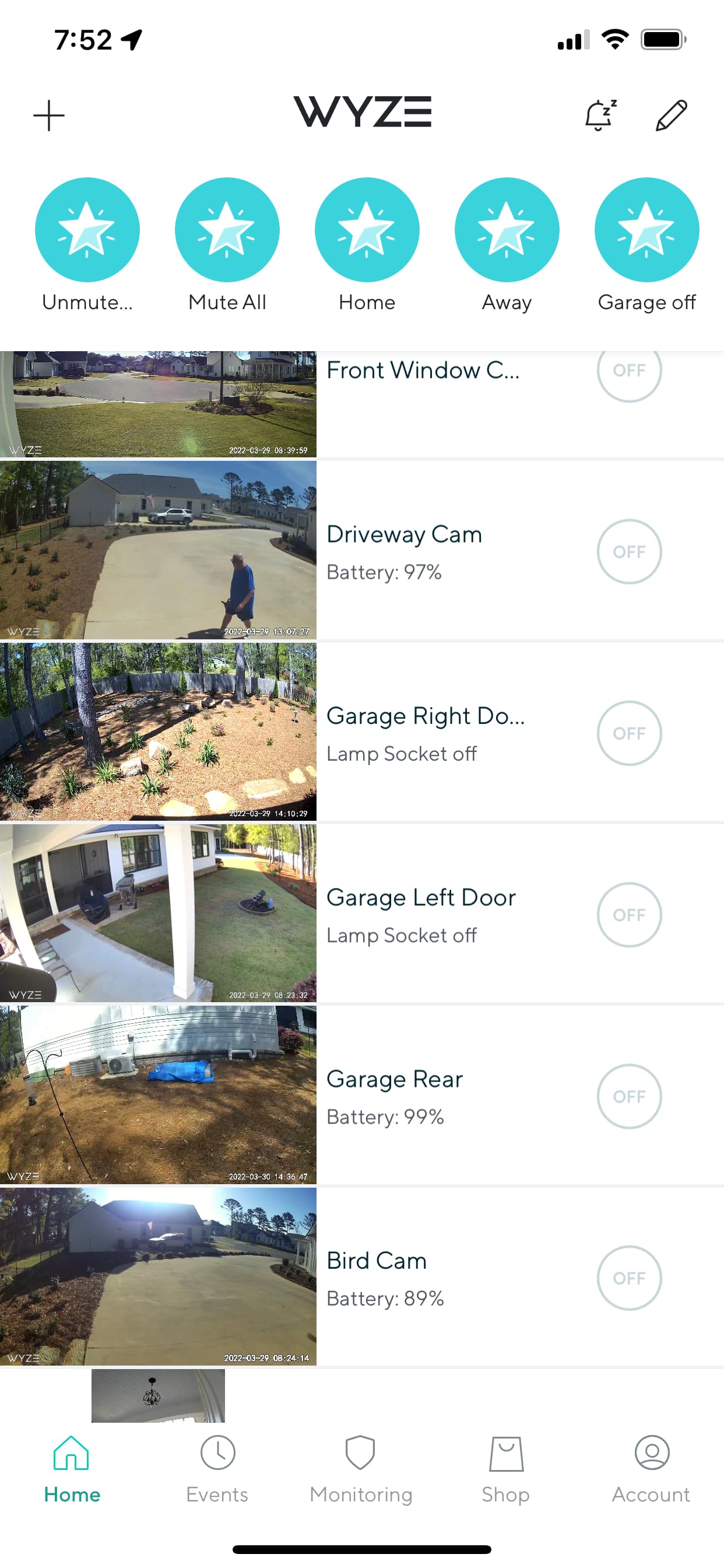

  2. Those 3 cameras are amongst 8 cameras that are in a group. Occasionally the camera names and images would get scrambled up in the Group display. That is, upon opening the Group, the label “Camera A” would be on the image from Camera A, and the next image would have the label “Camera B” but would actually repeat the image from Camera A.

Now, despite the deletion of the group, the images are mixed up again. See below … Bird Can actually shows an image that came from Driveway Cam.
There seems to be a firmware problem with the Outdoor cams causing the display mix up. I can’t remember which post but this problem has been seen by others.
