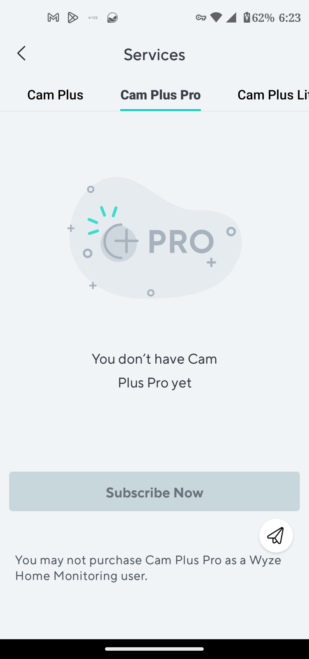

Go to Accounts → Services.

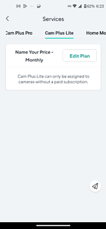

Verify that in the CamPlus Pro header, there are no licenses or cams listed. Then do the same for CamPlus Lite:
As you can see, I have an active CamPlus Lite subscription, but there are no cams assigned to it.

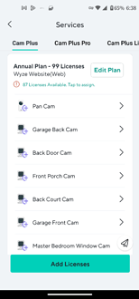

Then go to the CamPlus header and verify that there is only one license listed in that section and it has 99 license seats. It should list in the license title how it was purchased (you can see mine says Wyze Website (Web))
It should have the cams listed that you have successfully assigned, then a bunch of Unassigned Licenses. Scroll all the way down to the bottom to make sure another license isn’t listed at the bottom. I have an additional license, but as you can see, there isn’t an cam assigned to it.
If you do have a cam assigned to another license in any of these areas, it might be what is preventing it from being assigned to Unlimited.
If none of your remaining installed but not yet assigned cams are listed under a different license, and they do not show in the list when you press the blue “Unassigned License” under the Unlimited license, you may have to have Customer Support release those cams from their previous CamPlus License. There was another user with a similar issue that called Customer Service to have their cams unbound and reset. I will look for that thread for you.

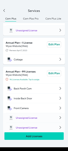

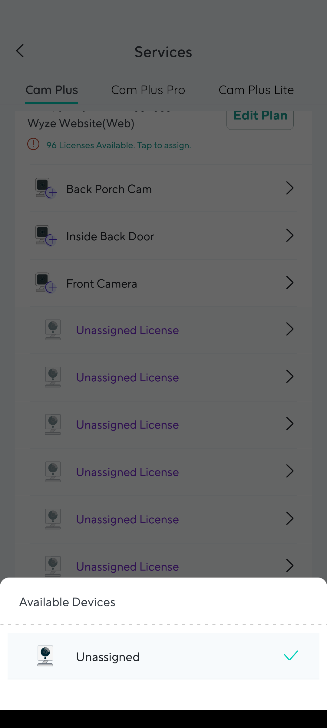

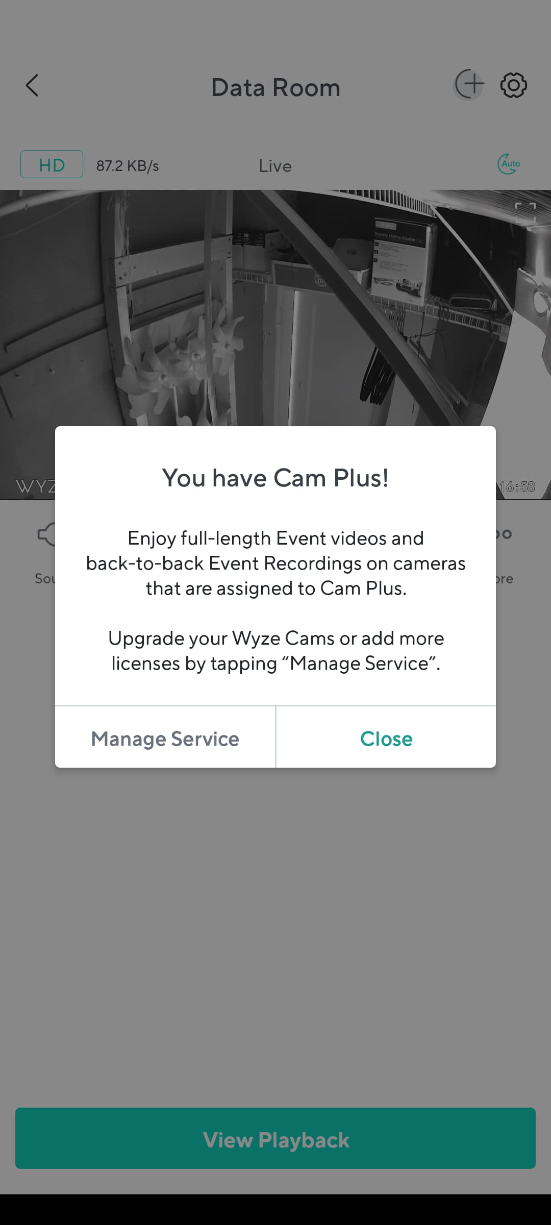

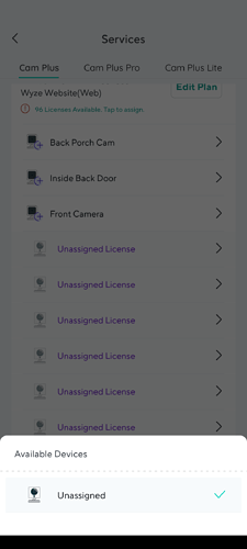

Here are the screen shots of what happens when I try to assign a camera from the App.
When I click on the + symbol to add the license, this is when the Manage Services button appears
I have 96 licenses available
The only item that appears in the Available Devices is “unassigned” - and there is no way to scroll to any of the other cameras that I have in my account.

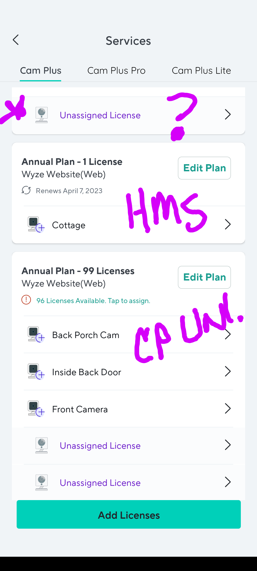

From your screenshot I see the HMS Bonus Free CamPlus subscription with one cam assigned. That Cottage cam will not show as available to be assigned to any other licence so long as it is bound to the bonus license… I also see the Unlimited license with the three cams assigned.
However I also see a third CamPlus license hanging out above the Unlimited license. If the cams you are trying to assign are assigned to that license, they are bound to it and will not show as available to assign to the Unlimited license until they are unassigned from the current license first.
If they are not on that license, it may indeed take a call to Customer Support to verify that your CamPlus Lite subscription has been cancelled and all cams released from that license.

If the cams are assigned to the license at the top of your CamPlus list, the one I marked in the screenshot, all that has to be done is to unassign them from that license before adding them to the unlimited.
However, if they are still stuck to the CamPlus Lite you cancelled, that is a glitch that only Customer Support can handle.
