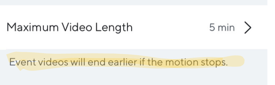

Are you sure your not seeing the “Max video length” setting? That is there so if you have a long motion event, it caps your video and stops the recordings.

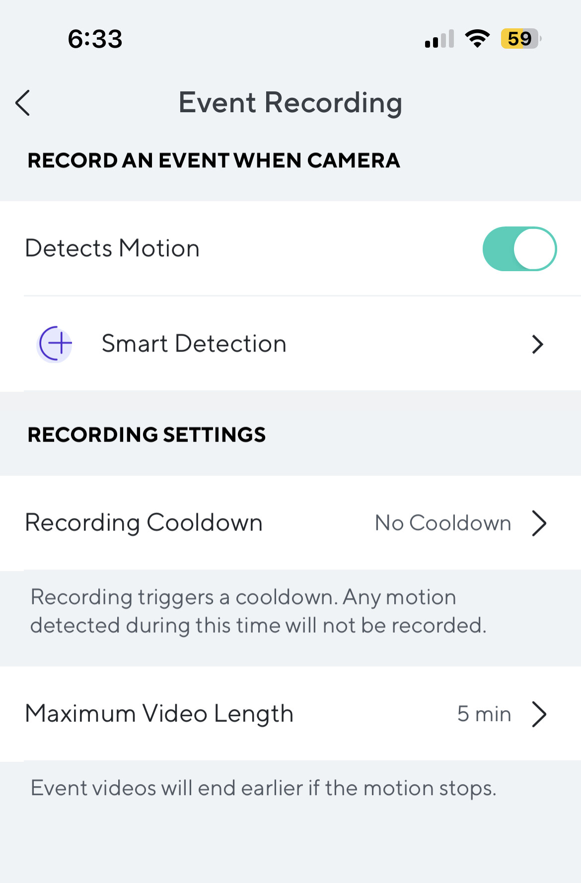

Guys, I have the camplus and also the video length settings at 5 minutes and still stop when motion stops !! Wyze need to fix this !
That video settings it’s useless !

Unless you have active motion that lasts longer than 5 minutes, this is working as intended. It’s “Max video length” not “minimum video length” or “set video length”. Clips will stop when motion stops, unless the motion lasts to the “Max video length” setting, then it will stop. Like it states in the notation of the setting.
It’s there to help conserve battery life.

Unfortunately your not understanding that settings function, that is not how it operates. I explained that above, I’ll link it here again for ease of reference.

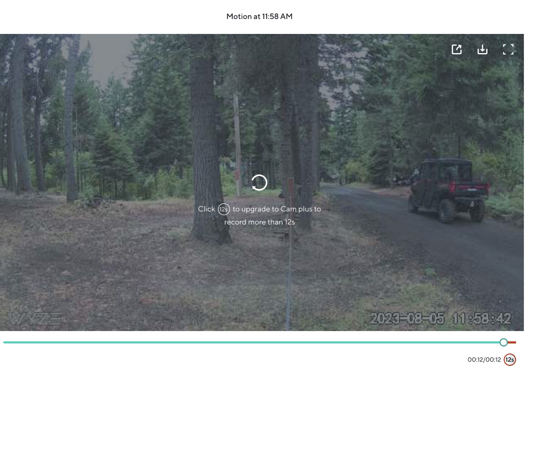

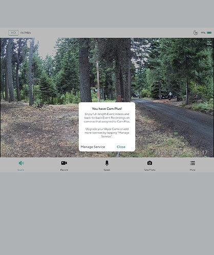

I have Cam Plus Unlimited Annual and for some reason one WCO V2 doesn’t seem to full take the license. Associated and reassigned license on both Android and IOS and all the settings are there but when any video is played it shows the 12 second warning that if I want longer I need to subscribe.
I have a ticket open with Wyze and submitted a log (1134382).
