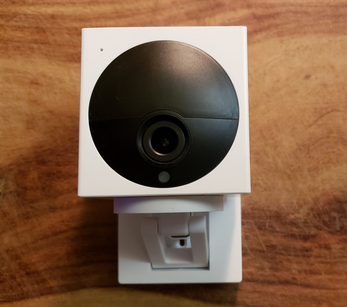

is this right or wrongwyze camera setting
The camera is in the upright position in your pic. Flip it and stick the top to the mount.
And then start a livestream > Settings (gear icon in upper right) > Advanced Settings > Rotate Image 180°
