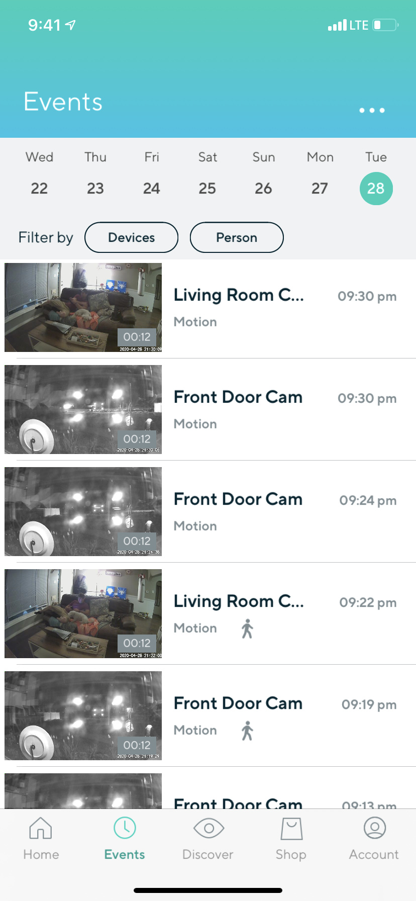

And obviously you don’t see any events like this under event tab
I did have a detection area set and then I deleted them. I have not tried restarting the camera- how can I do that? I have tried to ‘restart the device’ several times- is that what you mean?
And no events under the events tab.
