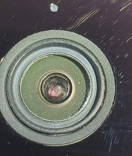

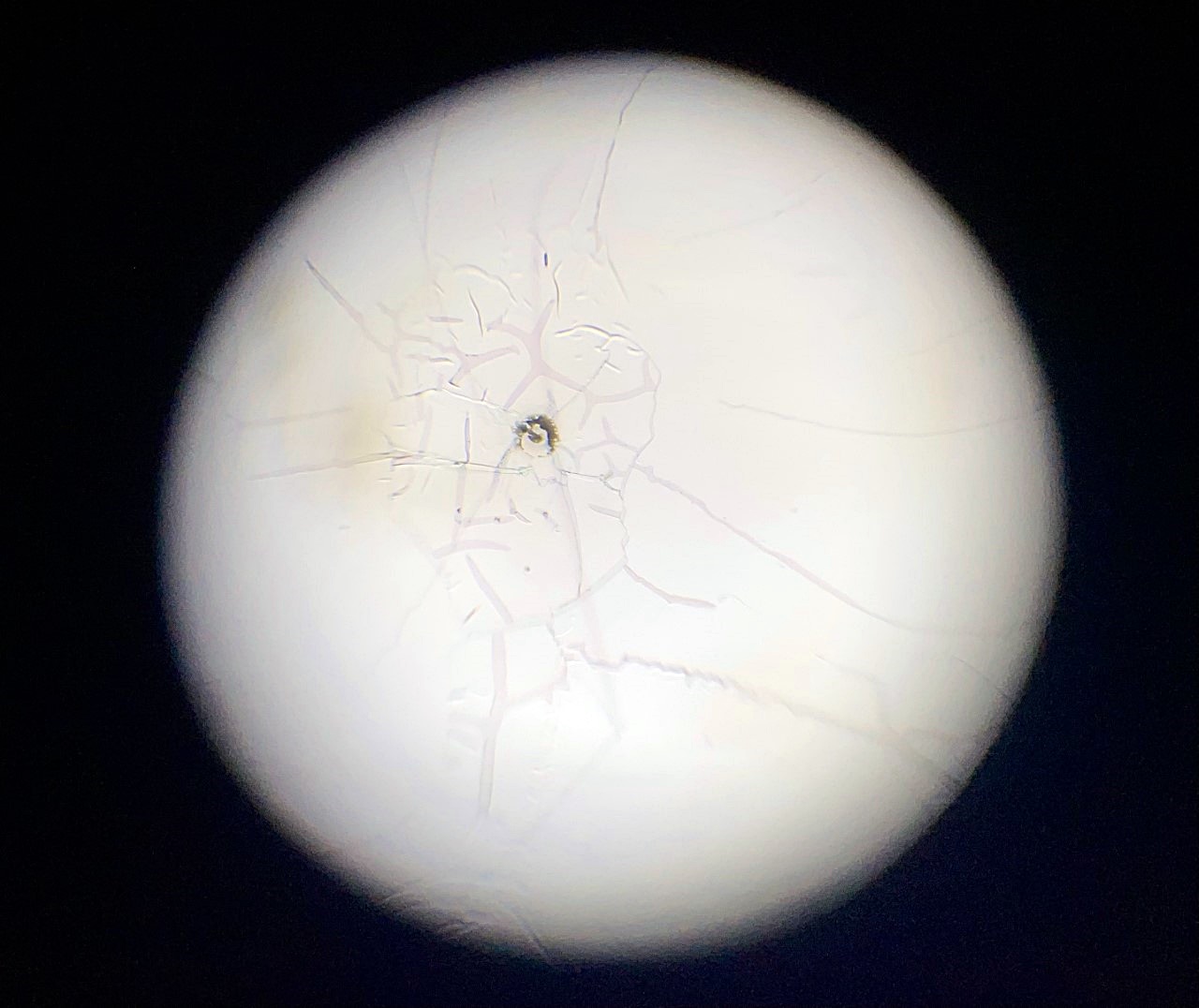

Take a look at the attached photograph. No its not some distant icy moon, its the lens of one of my V3 cameras taken from the inside, looking out.
No wonder the picture quality was poor.

Looks like the lens took some physical damage at some point (I assume those are cracks and not just some kind of stain?). Has the quality always been off with this cam, or is it more recent that you started to notice something was off on this particular cam? Any idea what the cause could be? Did it fall down or something? It looks like it had a very precise impact just to the upper left of center where everything else splinters out of.

No impact damage that I am aware of, this was my original outdoor V3 which worked fine for several months but then suffered from water ingress. I dried it out but the image remained blurry. I decided to take it apart and see if it was repairable and this is what I found.
Interesting. Did the water damage happen in the winter time? I wonder if freezing water could contribute to something like that.
It’s hard to tell but it almost seems like there is a little bit of some kind of clear film over the lens that bubbles up in a couple of places. I wonder if there is a separate outer layer of something that could be removed to clear it up.
It’s probably better to just try to get a different lens, but I wonder if something like windshield filler would do anything. My brother-in-law used some kind of stuff on a windshield crack and it seemed to make the entire completely disappear as if there never was a crack. I would’ve never believed it. But for something like a lens, I don’t think it would work as well because the high definition up close like that would be hard to hide when magnified.

It did happen over the winter and it did experience some heavy rain, I can’t remember it being cold enough to freeze at the time but I may be wrong.

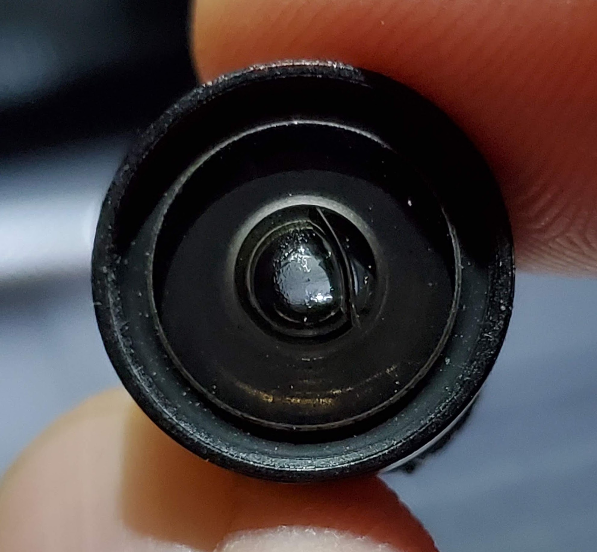

At the moment I have the camera free of the circuit board, now I have to unscrew the lens from the camera. It appears to be glued in place so I’m going to try some localized heat to see if I can get it to come off.
I’ll post some pictures if I find anything new.

I probably should have done that too but curiosity got the better of me.

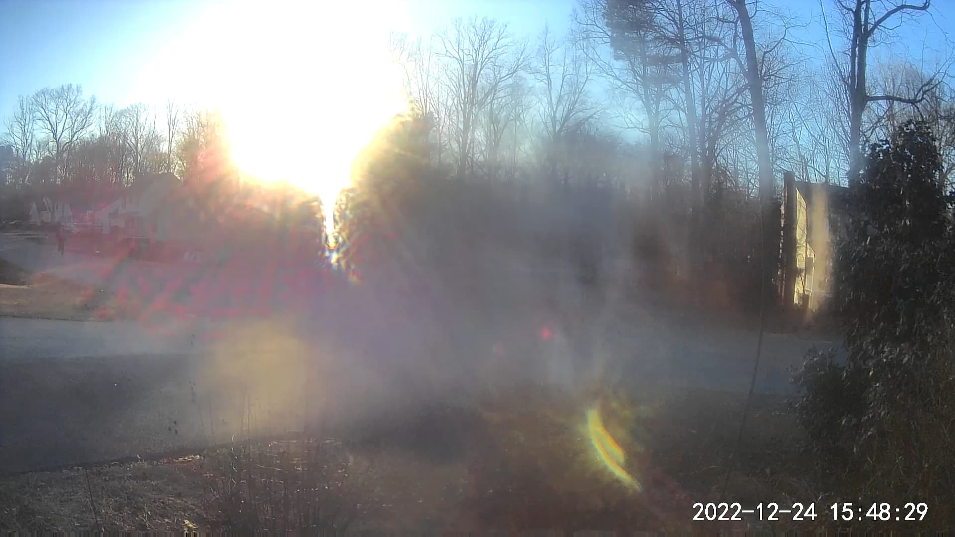

My issues started before the colder weather “blew in” but has been aggravated with the recent <10-degrees and -5-degrees wind-chill caused by the 20-30mph winds recently experienced. Earlier today when I checked it the haziness had mostly cleared but is still not as sharp/in-focus as it originally was or like the other V3 cameras I have outdoors. As it gets darker it will probably get worse. I also made sure to check the lens/clean with a Q-Tip before posting. Attaching a sample photo.
All: Make sure your camera is not pointed up, or even zero in any way. Down is best. My Outdoor Cameras often experience blurriness for a few days after any moisture if they are not pointed down.
Thanks for the suggestion and no it isn’t pointed upwards - just straight ahead. I didn’t realize these cameras are so fragile and “not really ready for the harsh outdoors”. I have V2 cameras outside that I had bought “outdoor mounting kits” for and have run for years without issues.

Unfortunately after they dry inside they are not the same, as it seems residual causes the lens to cloud. Pretty much trash after that. You can really see this haze at night toward a light, the light will now look rather large instead with all the light dispersion.
