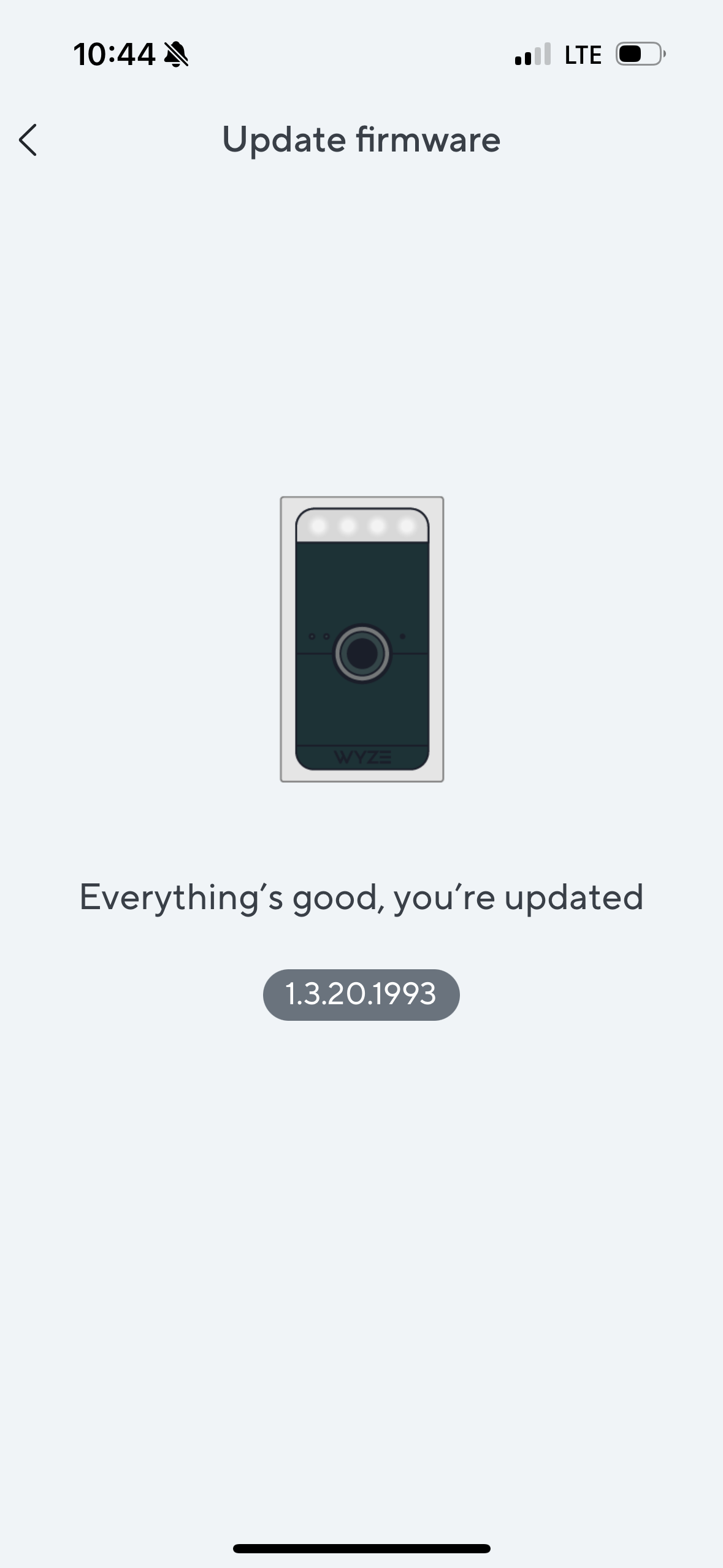

What is the actual firmware version on the camera? What is the actual app version that you are using?
I also deleted the app and reinstalled it so that’s updated too. Only other thing I might try is deleting the camera and trying to reconnect it. I’d just like to know if I’m the only one having this issue with this specific camera?
