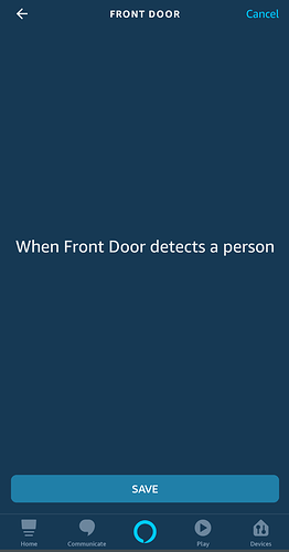

Announcement is on all echo. The way to limit is to disable announcement and to create a routine. Yes Routine are able to trigger on people detected. :slight_smile:

and you can select the announcement to be on your phone

Go to routines ,tap the plus to add a routine, when this happens, then smart home, tap on the camera in the list, tap on person, when (camera name) detects a person, save , then add an action, Alexis says, after that, I used customized, someone is in the front yard, next, then you can go to the bottom choose device and select this device for your phone to do the announcement.
This way you can only select one device for the announcement ,
but you can have it set it up both ways turn on person detection on the camera you can have it announced on your echo devices at home, then also set a routine and get announcement on your phone while you are away, Cool :sunglasses:
