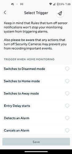

I have rules for my Wyze Plug\Sirens, Cam Sirens, Wyze Plug\Floodlights, & Wyze Light Groups to be triggered on Detects an Alarm. They do not trigger during the entry or exit delay countdown when a door is opened. Only if a sensor opens after the delay countdown ends and the system has armed.
These are the triggers. The actions you build into your rules will be executed when the selected trigger below occurs.
You need to be on the current Beta App and your Hub needs to be on the updated Firmware.
  • Go to the Account Tab
  • Click Rules
  • Click the + in the upper right
  • Click on Device & Service Trigger
  • Click on Name and name it whatever you want
  • Select the HMS from the top of the list. It will show as a Wyze Badge named whatever you named it in the Home Monitoring “Home Information” Settings.
  • Select “Detects an Alarm” (see note below)
  • Click Save
  • Click Add Action
  • Find and select the cam you want for the siren (see note below)
  • Click Turn On the Siren
  • Click Save
  • Click Save
Done.
Note: it is the same steps to build rules to do other tasks for all the triggers in the screenshot above. You can build rules to be triggered by any of these triggers. Every different trigger has to have it’s own rule. Rules can have only one trigger.
Note: you can continue adding actions into a rule by clicking the plus sign on add action so that one trigger can do many things. If you want more cams to siren, or lights to come on, or plugs to come on, add them into the same rule. Cams are also capable of multiple actions under the trigger. Each cam must be added as an action seperately for sirens.
