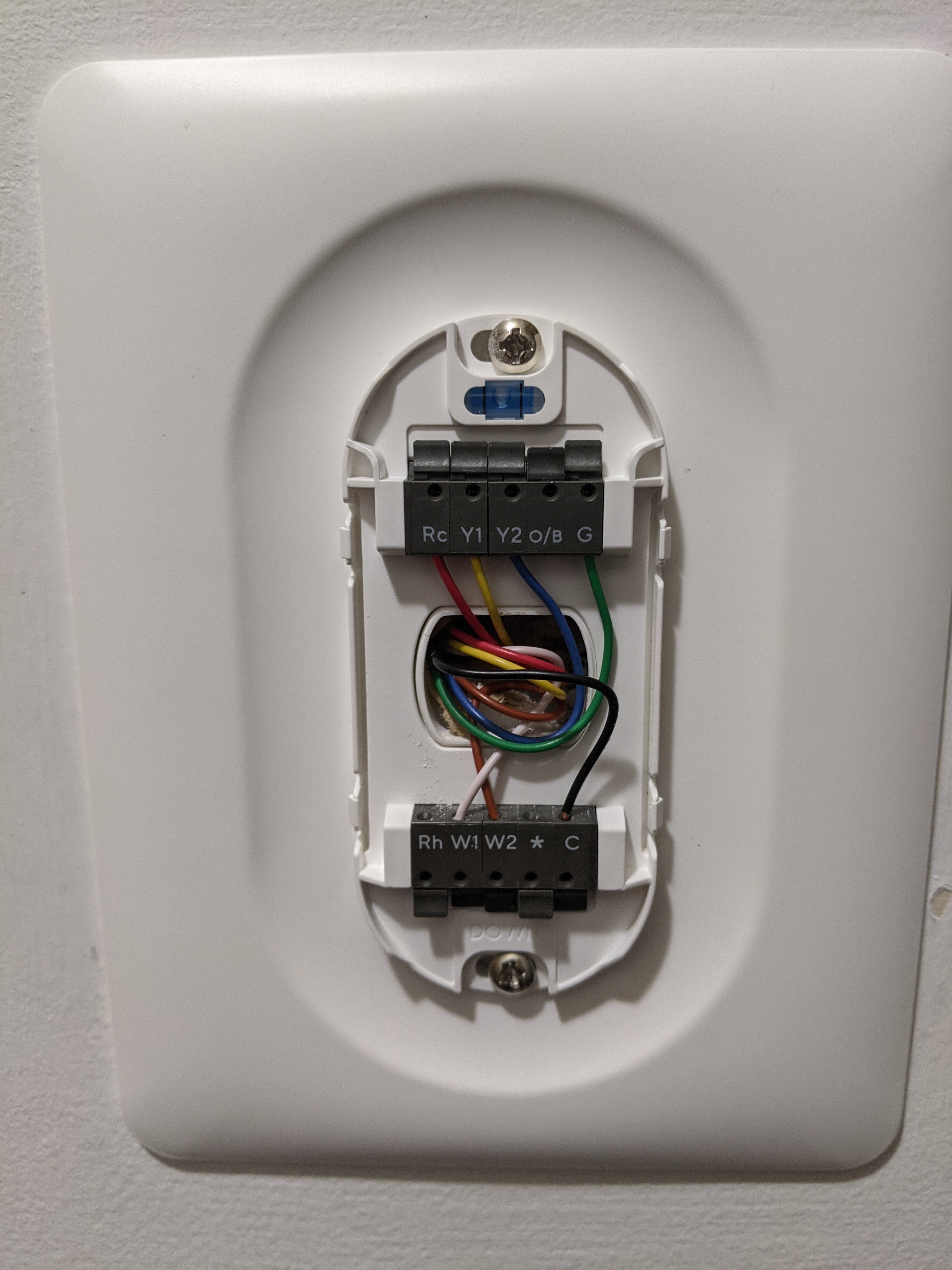

So, I have the thermostat installed, it powers on, and during the test, phase 2 of the heating does not come on. Originally there was a 6 wire thermostat with no C wire connected. It was only Y,Y2,W,W2,G and Rc. So I tried the C conversion device, and everything worked, except stage 2. So I ran an 8 conductor, and hooked up the C wire as well. As it stands, this is how the thermostat is hooked up:
The Rc wire runs to a black wire that runs through an overflow shutoff and back to the R terminal on the board.
When it switches to stage 2, the fan still runs, but the heat turns off. Any ideas?

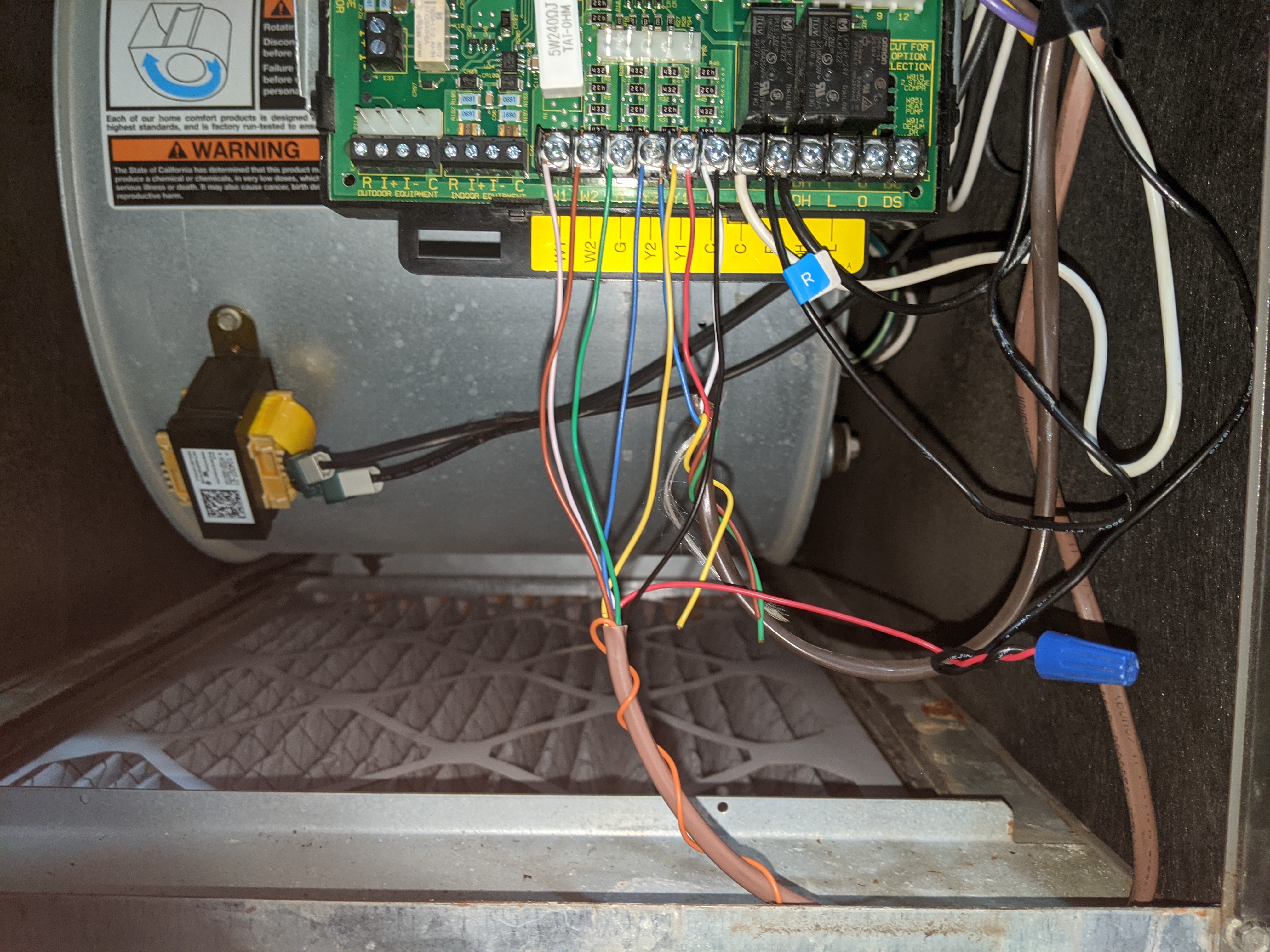

Here is a photo of the inside of the unit.
That looks like a Lennox Furnace, what model is it?
It is an SL280UH090V48B-04, running on propane.
Awesome furnace btw…
Your wiring looks correct on both the furnace and Wyze thermostat. During setup, did you choose “Gas” for the type, then “Forced Air”? Push the knob and hold for 10-15 seconds to prompt a reset of the thermostat. Delete it from your app, and re-add it with your new wiring and see if it detects the correct wires.
I did that, and re-added it in the app. Still the same issue.
Update: I just saw another post that showed setting stage 2 as electric, so I tried that, and it is now working. Is that ok, or should it be working properly with propane and forced air as stage 2?
