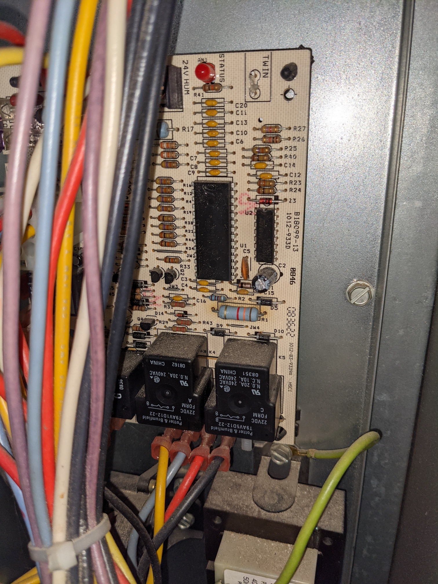

Please share pictures of your old thermostat setup
Ok, do you have a picture of your furnace control board?

PXL_20201228_211138336 PXL_20201228_211237639
I found a wire label wrapped around where they are conjoined with wire nuts that has this written on it.
White = W1
Brown = W2
Yellow = Y1
Red = R
Pink = Y2
Blue = C
Green = G
If you take off your old thermostat and gently pull on the wires, you should find a blue wire in there. It should be your C wire.
If you find it, tell the wyze app that you have Rc,W1,Y1,G,C
It should walk you through the setup.
From the first photo, it looks like there should be a blue wire in the thermostat cable that’s your “C” wire. It probably wasn’t needed by your old thermostat so perhaps they just snipped it off since there was no place to connect it. Try unscrewing the old thermostat plate and pulling the cable a bit (hopefully there’s some slack) to see if you have a blue wire – if so, mark it “C” and try the configurator again.
Hah-hah – @speadie was true to his name – replied quicker than me! “What he said” :wink:
Thank you both!!! It’s working and there was a blue wire that was snipped. I had some slack so I pulled about 4" out and stripped it and labeled it. Thank you again so much for the support!
