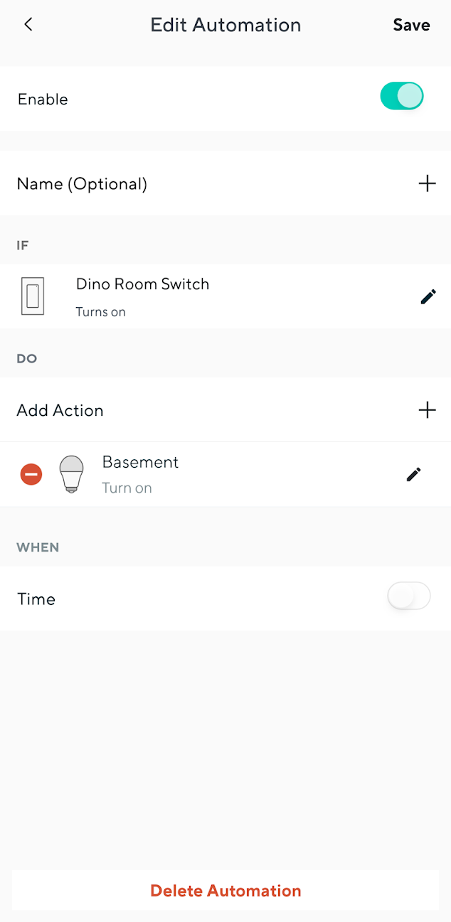

I’m confused…I have the exact automation…if switch turns on…. Do x. Works for me.
I figured out a solution to my issue with my Switches, but won’t elaborate here because it’s completely unrelated and I’d rather not pollute your excellent topic.
That is an interesting wrinkle. I’ve set the following Automation, just for my own sanity, with no success.
I wanted to make sure that the issue wasn’t with specific devices, but even though I can set this kind of behavior through the controlled Smart Devices in the Switch settings page and have it work, if I set up the action as an Automation it doesn’t work. I’ve done a little additional testing as well, with other Switch / device combos in my house, including with a Switch that I haven’t had any issues with at all (although all it does is control a group of smart bulbs) also with no luck. I simply can’t get any Automation to trigger through any Wyze Switch, and as far as I can tell the Automation isn’t even trying to fire, as it never shows up in the Automation History list. Even failed Automations (like ones including offline devices) show up in there when they activate. The only devices I can actually get to work is is ones I can assign through the One-Press Smart Control settings or the Additional Controls in the Switch settings page, which is either a filtered list of only light-related products or through double- and triple-taps, which isn’t exactly convenient.
