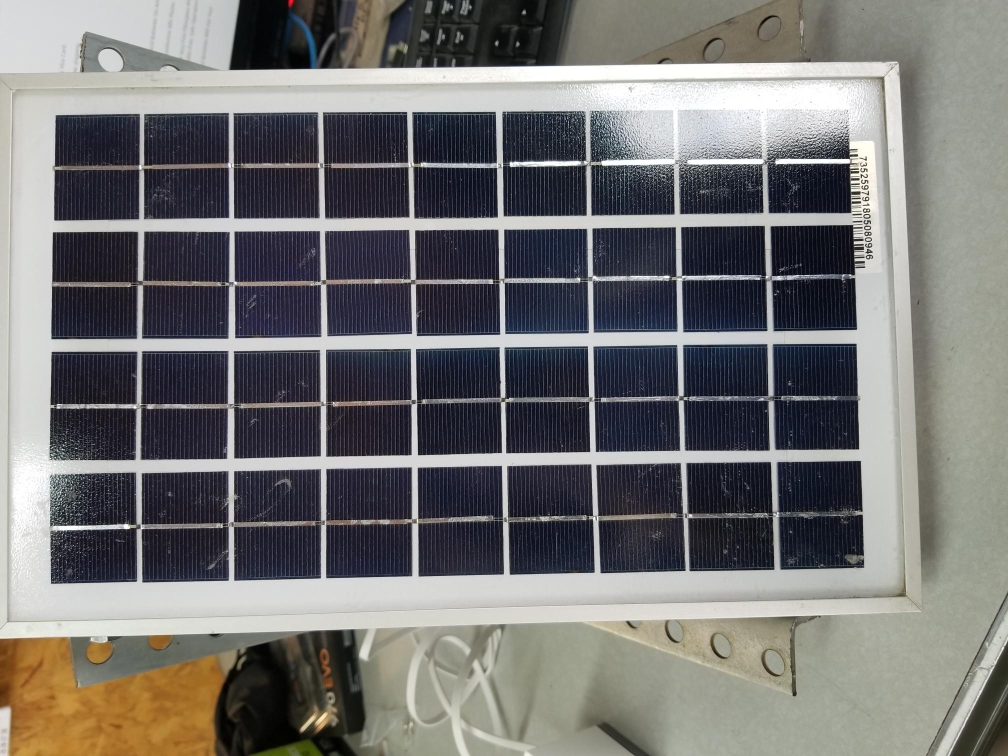

I have a need for cameras to be outside where there is no power. I use Ubiquiti products everyday, so I just “beam” 2.4Ghz wireless to the cameras that can’t connect to my home/office WiFi already.
Next I procured parts to create a solar system for the Wyze Cameras based on their electrical requirements. Based on what one camera uses 24/7 I decided on these parts off of Amazon. I would post the direct links, but I don’t know if I am allowed to.
Eco-Worthy 12v 25w Panel
10A Solar Charge controller 12v/24v Dual USB
LeMotech ABS Plastic IP65 Junction 7.9"x 6.1"x 3.1"
Expert Power EXP1245 12v 4.5Ah
Angle Iron for attaching everything together and mounting.
Some small guage wire to run between the battery, panel, and the controller.
I have found that even with a 10w panel the camera is powered 90% of the time in summer, and 50% of the time in our grey winters (with the panel facing south). Upgrading to a 25w panel increases the size of the panel a lot, but it charges the battery up MUCH more letting the camera stay on longer and gives the battery much longer life.
I run a USB cable out of the junction box to the attached Wyze Camera. I find that keeping the camera out of the box allows for the panel to be placed in an optimum location with the sun, while still putting the camera in an optimum location/angle for its viewing.
The problem with this solution is that it comes out to about $90. Which is much higher than I had hoped, and makes it a difficult solution to implement frequently. However, the solution does work great. If you wanted to it should be easy to upgrade the battery and panel to accommodate a small hotspot that can be powered off of USB. I would be very selective though on the power requirements of the hotspot. With a hotspot though comes data fees and overages, so you would have to be careful about what plan you are on and how much data you use.
Attached are some pictures of the project for your enjoyment and or replication. This isn’t pretty, and I’m sure many of you could build something much better! Please do, and post it back here. I’d love to see what other ideas people have!
