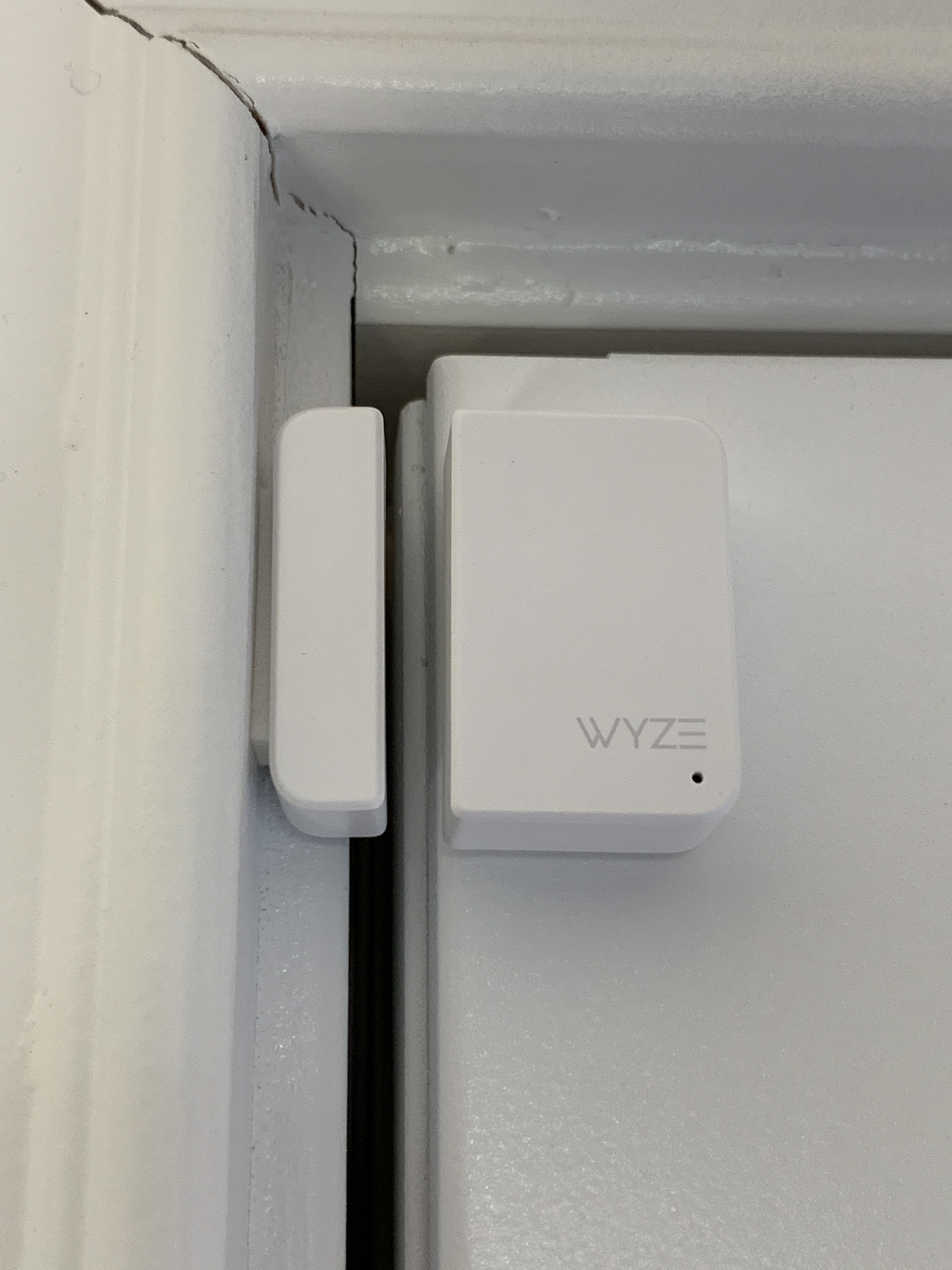

I have installed four (of the 12 I have purchased) Wyze Sense Contact Sensors so far. Last night I installed one on my back door (see picture #1) and what I noticed this morning is that the magnet is so strong (as it should be) and the adhesive is so spongy, that the magnet actually pulled itself over to the sensor and made contact (see picture #2…picture was actually taken after I pulled them apart and tried to re-stick) which now makes it impossible to close the door. The adhesive on the magnet on my attic door performed similarly (picture #4), but adding Scotch Mounting Tape (pictures #4 and #5) probably fixed this problem.
I love these things, and I plan to buy more, but my impression is that the adhesive strip is way too thick, which makes it too spongy, so much so that there is too much wiggle on the thin magnet. Not a deal breaker, because I purchased a roll of Scotch double-sided indoor Mounting Tape, and was able to attach a small strip to the other side of the magnet (opposite the sensor unit), and it now holds in place just fine (see pictures #3 and #5)). My recommendation to Wyze, however, is to replace the thick, spongy adhesive on both the magnet and the sensor unit with a thinner adhesive similar to Scotch Mounting Tape. Hope this helps others!

During alpha and beta testing, Wyze determined there were issues with metal doors interfering with the communication with the bridge when using thinner adhesive strips. They improved signal with the thicker strips. I personally use 3M Command Strips to mount mine.

To fix the problem, I took off the spongy tape, and put 3M command strip on it instead. And instead of putting the command strip on the smaller side of the magnet, I turned the small piece 90 degrees, and put it on the flat surface there.
Doing both these things really locked the small piece in place, and will not allow any flex towards the sensor part.
This has completely solved the issue for me.

I just rip their adhesive off, and put on 3M command strips.
Works perfectly, and very strong hold.
The beauty is, the way the command strips are, with the velcro on it, they stick out far enough to accomplish the same thing as what they were trying to do with their own adhesive.
PS: But yes, I had the same problem with the small piece. It didn’t fall off, but it ended up “flexing/bending” over towards the main sensor part, thus causing it to not trigger when it should.

I had similar issues with some of the narrow magnetic parts bending toward, and eventually connecting to, the sensor part. To remedy this, I added a small strip of 9 lb Scotch (by 3M) Indoor Mounting Tape to the side of the magnetic portion, which holds it very securely away from the sensor part. My Wyze Sense Contact Sensors are sturdy now; however, I do agree that R&D should have caught and corrected this issue before going into production. The best part is that I didn’t spend an arm and a leg on my Contact Sensors AND have to purchase additional tape. All in all, still a great deal—and I’m confident that Wyze will take all the feedback to heart and eventually ship v2.0s.
