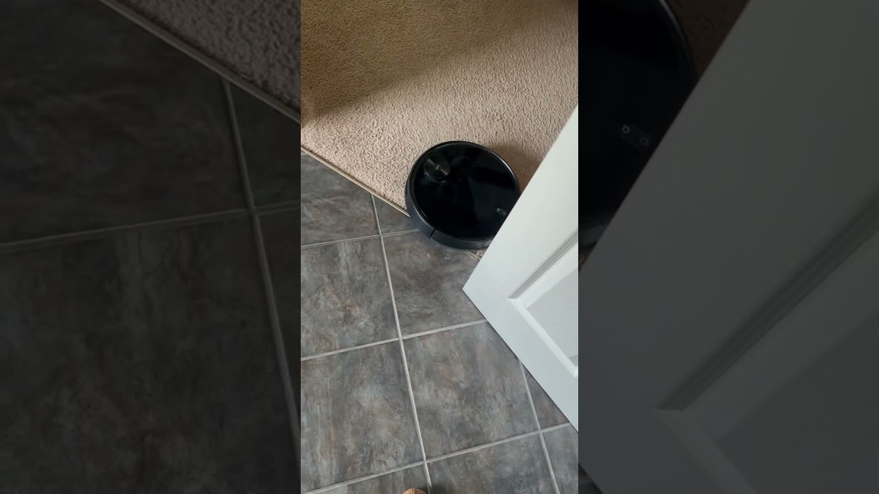

Our robot vacuum is making a very loud noise but only when it turns. I’ve flipped it over and looked at the wheels and there’s nothing obvious obstructing the wheels.

I got it up on plastic bins and ran the cleaning cycle.
If the lidar sensor is forward (away from you) then the left wheel sounds like it has something in it.
Due to the way the wheel is designed I can’t see any obstruction or foreign material and I don’t see an easy way to disassemble it.
Warning this video starts LOUD.
It seems to be doing it less now. I did remove some dust from the wheel.
I think I need a longer video, I still think it’s the main brush. I’ve heard of issues with it being very loud especially after replacing it with a generic/compatible one. Are you using the original brush?
The main brush stops and goes on its own when there is too much friction. It’s one of my complaints as it does a less than stellar job when the carpet pile is too long.
Can’t imagine how the wheel assembly would be that loud and still function.
Listening carefully, the vacuum motor sounds fine to me.
