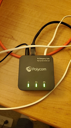

When I lose power my phone company sends a text message about the disconnect
When it reconnects, it sends another text.
What about the cost? $0. I use Google voice that routes through IP to my house phones.
That’s interesting. How does the phone company know you lost electrical service? They have business tie-up with the electricity supplier? This isn’t something a normal household has.
The Wyze app already has that feature, sets the status to “Offline”. Why add a hub to do what is already being done?
I paid little for the box and hooked it up. No maintenance fee. I used the Google number I used as a second phone for my cell. No annual costs.
