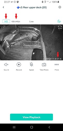

Your cam’s settings aren’t being reset… they just weren’t loaded yet. Your cam settings are stored in the cloud. When you select a cam to view (live stream), your settings are pulled in from the cloud. If you choose to review your settings before they are loaded from the cloud, you will erroneously be seeing the Wyze default settings instead of your preferred settings. To get around this when “things are loading slow”, when you select a cam and have the live stream displaying, don’t select the gear icon (settings) until you no longer see “Getting video data… (3/3)”, you see your preferred video quality setting icon and the data rate (xxx.x KB/s) and the date/time are actively updating on your display.
Ah ok. I was able to confirm what you’re saying. If I wait until the (3/3) mark where the video gets updated I can indeed see that my settings are still there. Cool…

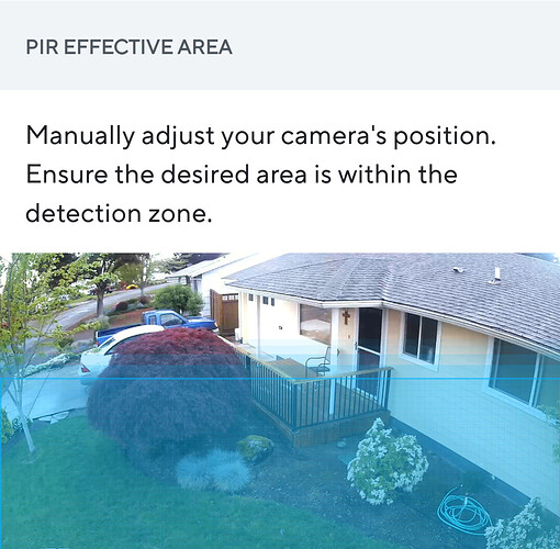

I am having a problem also setting up my outdoor cam. My question is which is the PIR detection Zone. The shaded area or the clear area? I need to manauly move the camera and it is up in a tree in the front yard and on a telephone pole in the backyard. Thanks for any help with this problem. It is not clearto me from available info which is zone.
You are correct. In the below image, the boxed in squiggly lines area is the pir detection area.
