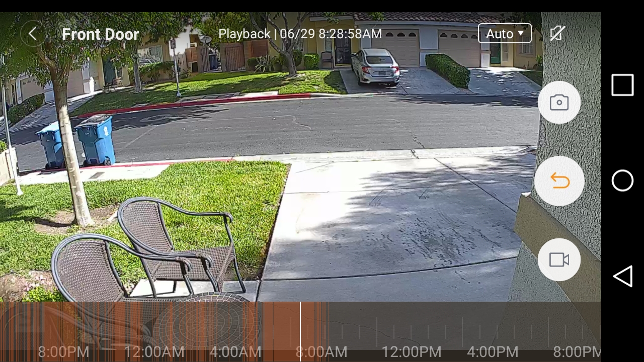

This is on the Wyze app, pinch in and out on the timeline to make the timeline zoom in or out to show more or less time to be able to swipe to.
I’m sorry, I just don’t seem to be able to do that on my Wyze cams. I can scroll the timeline on Wyze, but can’t expand or contract it with pinching, etc.

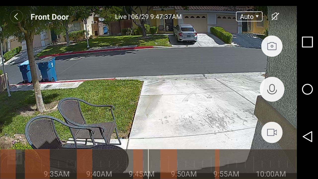

I sometimes have issues with the pinch in or out in the direction of perpendicular to the portrait orientation. But it’s there…here:

You are not alone. I’m using Android 8.0 and the pinch zoom doesn’t work on my LG V20 either. I can slide the time line back and forth very quickly, but it will not zoom at all.
However, it does work on my iPad. I can pinch and zoom in on a specific time very easily. But my Android has never worked for this feature.

Just tried an LG phone - Android 6, and a Samsung phone - Android 9
I know they used to work, but today they don’t. How did you guys do that?!? :wink:
So then I try a Samsung tablet - Android 8 and it works perfect.
All latest app version.
Soooo then I go back to the two rebellious phones laying on the table, and now they work. But it does take a lot of pinching & zooming. And they are smaller screens of course.
But it’s not the screen protector because, as @StopICU33 says, the timeline slides like butter.
Anyhow, my experience kinda fits my frequent complaints about poor SD card access - the longer the phones stayed open to that screen, the better they seemed to zoom the timeline. My internet is especially flaky in today’s heat, but everything is on the same LAN.
And of course, it works perfect on the Apple devices.
So I think its more of a video optimization and/or network communication thing than an Android version thing..?
