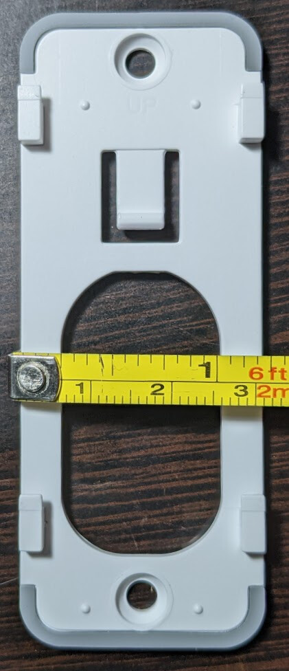

Not sure if you can provide it, but can you give me the measurement of the back plate the doorbell attaches to? I’m actually working on an idea and would like to create the plate via my 3D printer.

I measured with 2 different measuring tapes. Both showed: Just under 8cm X just over 3cm (basically 7.9cmX3.1`cm)
I’ve included the measuring tape pictures in case you need a reference for where the connectors are in the back plate (where they snap in) and how far apart they are…that’s a lot more important in some ways.
Hope that helps.

Thanks carverofchoice. I appreciate this. I’ve got a initial design down but this helps with specifics. Once I get the design down and tested (after I buy the camera). I will share the directions and 3D design to everyone do you can print on your own.
