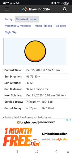

Update on this: The sunset is currently around 6:37 PM Eastern Daylight Time at my location. The time is correct on the cameras. The Motion Warning is still set for “15 min before Sunset - 8:00 AM” on all the outside v4’s. So it should be turning on around 6:22 PM. Last night I checked at 11:01 PM and there were no warnings from any of the cameras. This morning I checked at 6:18 AM and there WERE warnings.
So the feature is working, but the sunset time is somehow horribly off. It must think I’m somewhere on the planet where the sun is setting sometime between around 11:17 PM and 6:33 AM. Or it’s using the wrong time zone for the calculation.
