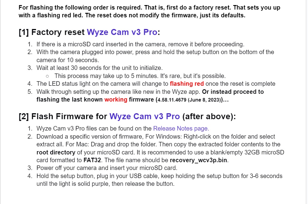

Hey There, my pro 3’s went offline,
Is there a way to update the firmware when the app says the camera is offline? Tried a factory reset, but it says can’t find the network name
Thanks!
Make sure your phone is on the 2.4 GHz network then try this.
