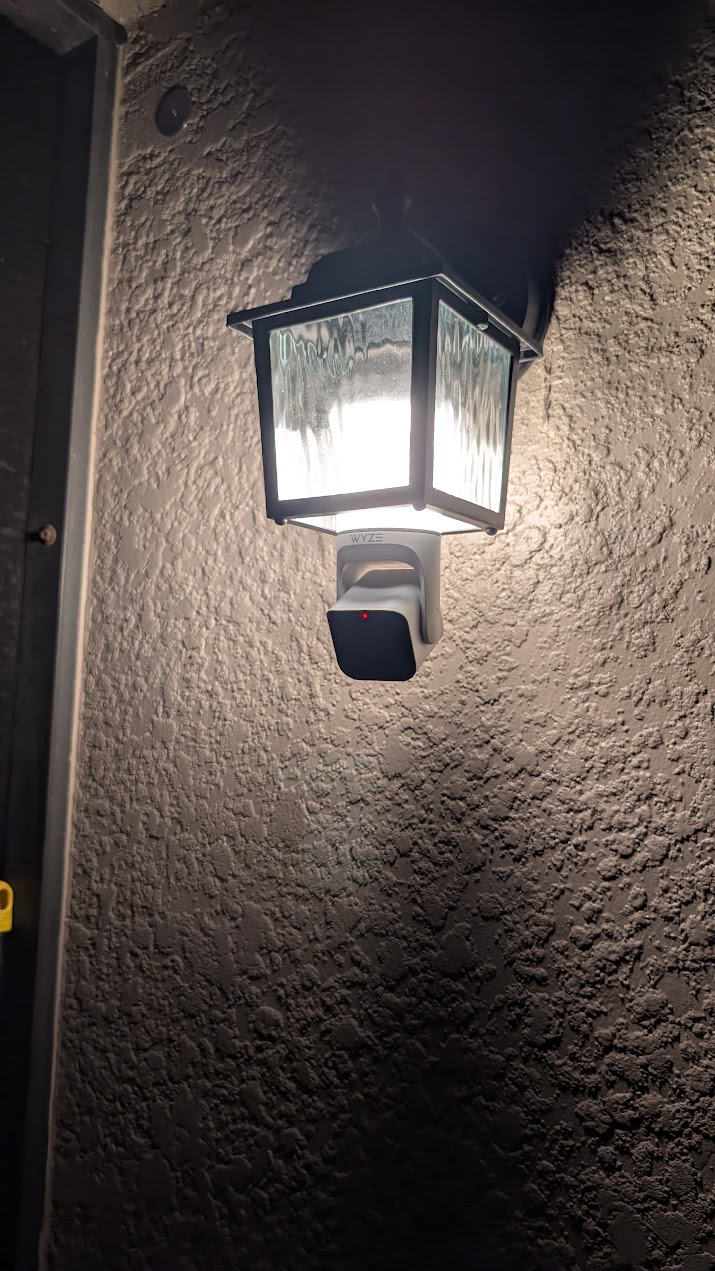

I recently purchased a Wyze Bulb Cam for my back patio/lanai.
I’m having trouble keeping the device powered on as it loses power / turns off after time.
Initially, I had the bulb cam mated to my sconce and a lutron smart switch. I was not able to finish setup under this configuration as the bulb cam just kept losing power. It would power on fine as soon as I flipped the switch button, but would lose power after a few minutes before I could finish setup.
So I thought…maybe the issue is the lutron switch or the sconce.
So I removed the lutron smart switch and put back a regular non smart button switch from eaton and was able to finish setup of the wyze bulb cam and it worked for a time.
Come the next morning, I noticed the wyze bulb cam was off (non smart button switch was flipped on and was not altered) again. In order for me to turn it back on, i have to turn off the non smart switch, wait a few minutes and flip it back to on.
The only thing left that i haven’t changed is the sconce. But before i do…Anyone else having a power issue like this with your wyze bulb cam?
This is kind of a frustrating problem to have just to get this thing to work…

Does that fixture have a dusk to dawn sensor on top (looks like there is something on top of the mounting area)? Even if you’ve disabled it and set it to switch-only, which is often done by just putting a plastic cover over the sensor making it think it is always night, those photocells can still interfere. Hopefully the tab solves it, but that’s something else to consider if it doesn’t. May have to replace the fixture with a plain old “dumb” one. Something that would have caused a barely noticeable flicker in the old bulb may be freezing the bulb cam up (electronics don’t respond well to brief voltage sags).
There are even some fixtures where the photocell (or motion sensor when it has one) actually rely on the bulb being a constant resistance or they won’t function properly. The wyze bulb probably won’t be constant like that. But those fixtures usually will say that they are for incandescent bulbs only and aren’t that common anymore.
But hopefully it is all good now.
Just to update…Dave27, you were right.
The sconce does have a small dawn sensor on top. I didn’t know what it was you had mentioned it and I studied it more closely and looked at the description/advertising for the sconce from Wayfair (where i bought it from).
This is probably what was prohibiting me from setting up the wyze bulb cam during the day time initially.
For now i’ve since covered up that sensor with black electrical tape as a temp fix until I can find/choose a new sconce that I like.
If it works fine with the electrical tape (no interruptions or other odd behavior) then no reason that can’t be a permanent solution. Even a sharpie or one of those wonderful smelling “Marks A Lot” will probably disable it.
Only reason it came to mind is when the LED switchover began years ago a lot of the older fixtures with motion and light sensors in them would not work - they were designed to use the resistance of the filament in the bulb as part of the circuit, and the LEDs would either flash on and off or the sensors wouldn’t work at all. I doubt your fixture is like that, that’s something you’d find in like 20+ year old ones typically.
Of course “dumb” sconces are cheap and one that is a bit taller might hide the cam a bit more, so up to you obviously.
