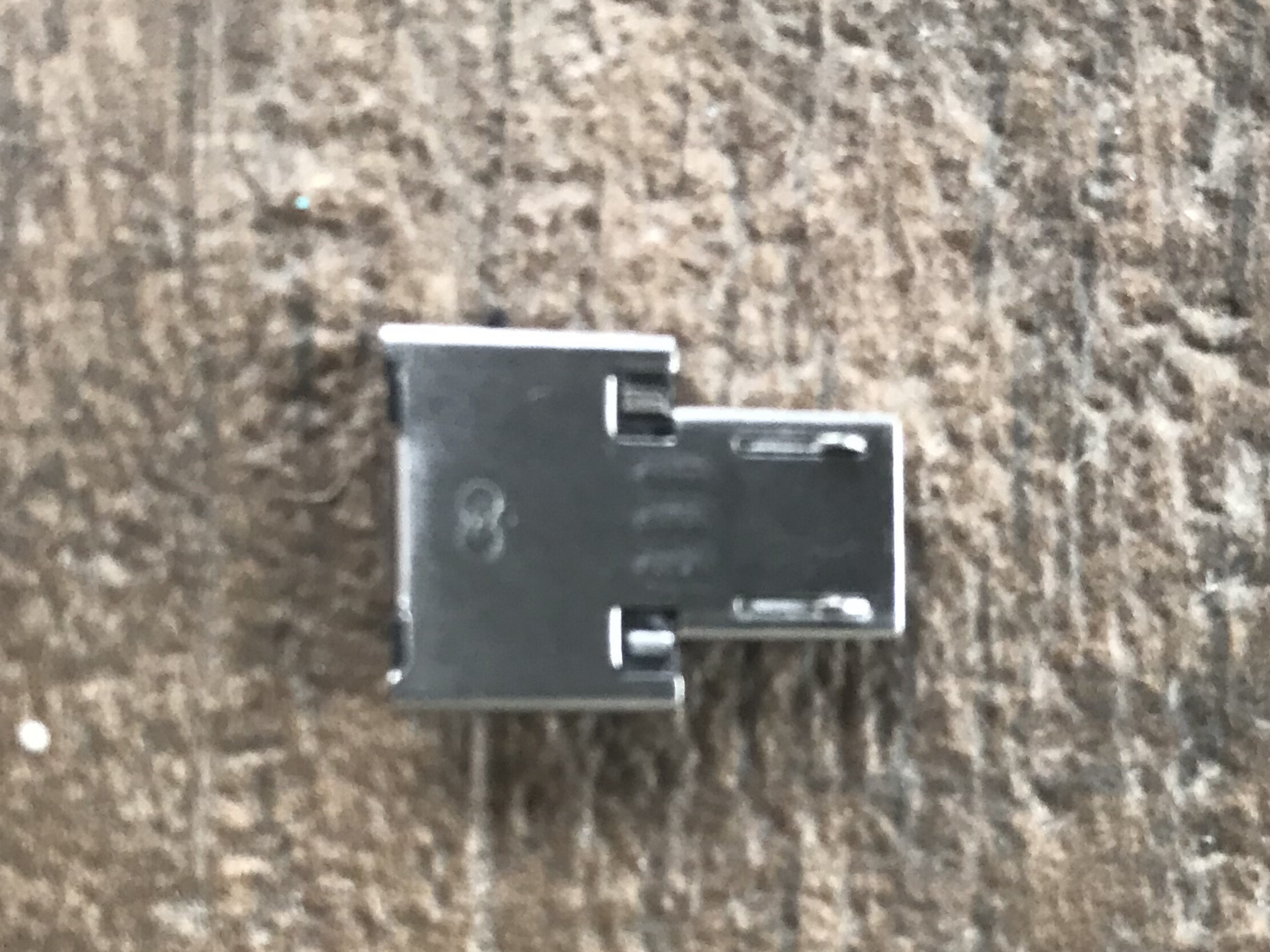

Found some USB to microUSB adapters on Amazon. These make it look much better than having a black adapter sticking out.
CHENYANG Ultra Mini DM Micro USB 5pin OTG Adapter Connector for Cell Phone Tablet & USB Cable & Flash Disk - 5pcs Amazon.com
