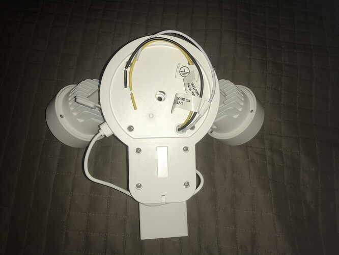

WOC floodlight with motion sensor
Replacing a Ring Spotlight Mount with a Wasserstein floodlight
The WOC mounts to the floodlight almost like Wyze made the floodlight. Since the WOC has a weather resistant power connection, I was impressed with how Wasserstein managed to keep the same IP65 rating
This comes with a remote so no climbing back on a ladder to adjust the sensitivity and range.

The two notches are there to clear the silicone cover on the camera. I will fill these with a dab of clear silicone.

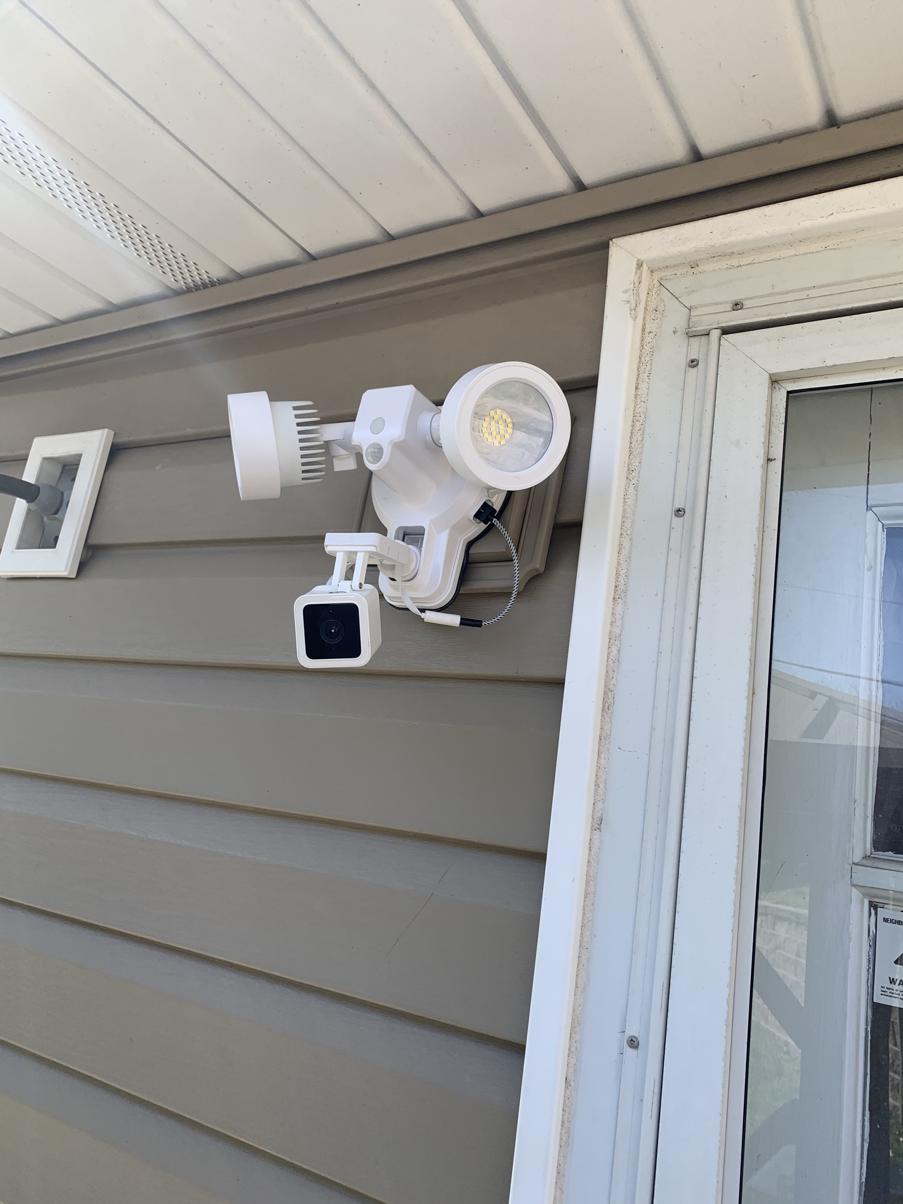

Here is the finished installation. Mounted the camera right side up because when I tried to rotate the image 180, the app advised against it. They know more than I.

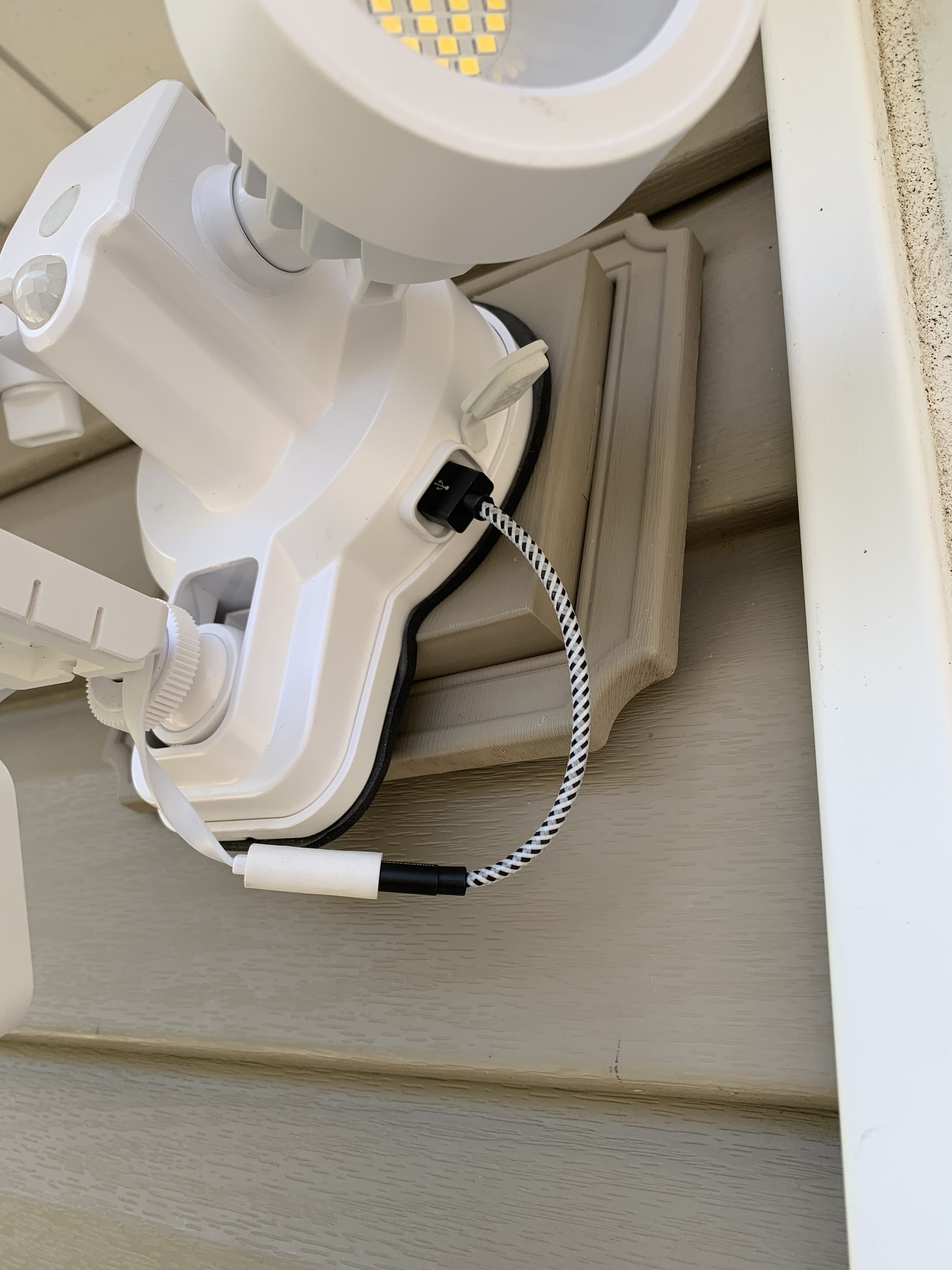

Got the Wasserstein v3 floodlight mounted on the back of the house. There is no cable included to connect the v3 to the floodlight. Had to supply that. Have a ticket to support why it wasn’t included. The floodlight housing has a regular USB and the v3 has a microUSB.
The v3 base clips into a holder with a standard female 1/4 20 thread. The floodlight housing has a vertically adjustable mount with a male 1/4 thread
Both the WOC and v3 floodlights are identical except for the different mounting bracket. I can take the v3 and swap it with the WOC just by swapping the mount.

Opt for the v3 model. I have one for the WOC and one for the v3. The floodlights are exactly the same. The only difference is the supplied adapter. The WOC is not meant to be powered 24/7 and will void the warranty because the charging port is not completely sealed with the Wasserstein adapter.

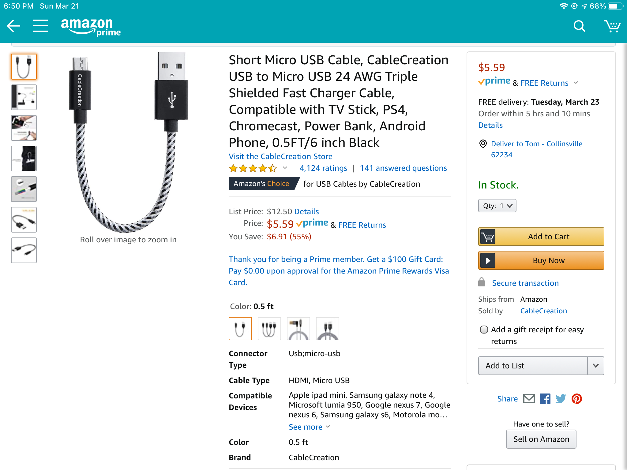

I had this braided one from Amazon in a drawer.

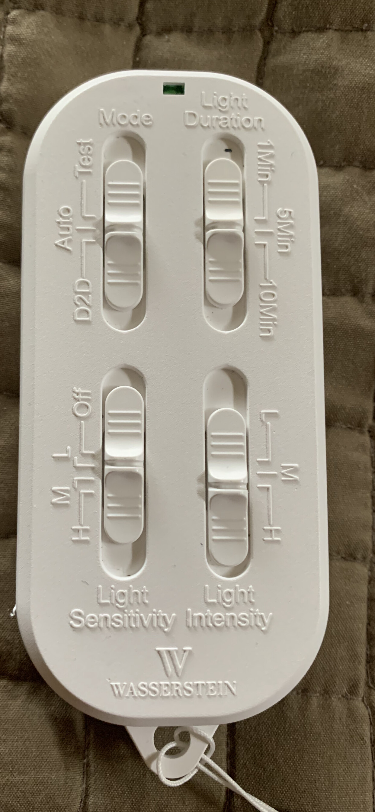

There are four settings on the remote. Two are for light intensity and duration. The other two are for sensitivity (wish some people had this setting) and the other for auto / D2D / Test. Support emailed what the remote settings should be. I will move it from Auto to D2D and see what happens.

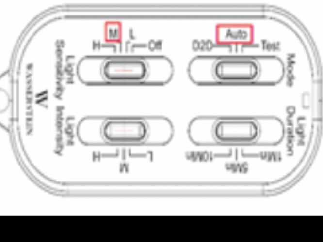

Here is what Wasserstein support said the settings should be :
I flipped the remote to D2D and will let you know. I really like the quality of the light and hope to keep it.

Finally got someone at Wasserstein who knew what the issue is. Seems the setting “light sensitivity” High Medium Low and Off mean if it is set to High, that means the light will not come on unless there is motion and it is really dark. I had it set to Low ass u m ing the exact opposite. The Low setting results in the light coming on in low light conditions, not dark. Setting it to Off explained why the light turned on even in broad daylight. I have it set tom High and wil l check the cameras tomorrow and see if the lights came on less. I am thinking they will.
