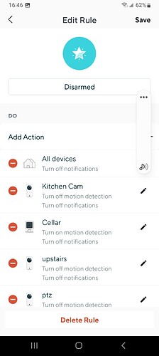

So you setup those 3 shortcuts, and what actions do they have? Could you send a screenshot of the rules
This is the 2 main modes I use and they work - Night Mode and Disarmed.

Here is 2nd screenshot- New users can only upload one per post:
I’m not sure what your wanting to happen, but note that when you have some actions that turn something on, and others that turn it off, it runs them all at the same time in a random order.
These aren’t toggles, it just runs the commands.
So clicking the night mode runs all those commands and then it’s done. They are entirely stateless.
There is no way to tell what settings state any of your cams or devices is in after running one of your three Shortcut Rule commands.
The only visual references on the Device List Home Page that will give you any indication of which of the three was last run would be the Global Notifications Bell in the top right and the Green on\off cam status.
The quickest way to tell what state you last left them in (which one you pressed last) would be to click Account → Rules → History and look to see which Shortcut Rule you ran last.
As @IEatBeans indicated, the Shortcut Rules buttons are fire and forget. They are not an on\off button but a 'Run Rule Now" push button.
Also, there is some redundancy in your rules. If you are turning off Motion Detection, by default you won’t get any notifications from that cam because there will be no Video Upload Events to the server to initiate them. Your cams stop recording to the cloud. You don’t need to turn off cam notifications if you turn off motion detection.
Also, turning off all notifications for all devices will silence the app notifications altogether, globally (this puts the zzz on the Bell). This blocks all cam notifications so individual cam notifications off wouldn’t be necessary. But, the cams can still upload videos if the Motion Detection is on.
If you just don’t want notifications, but you still want the cams to maintain security watch and continue to record to the cloud, the bell icon is all you need.
