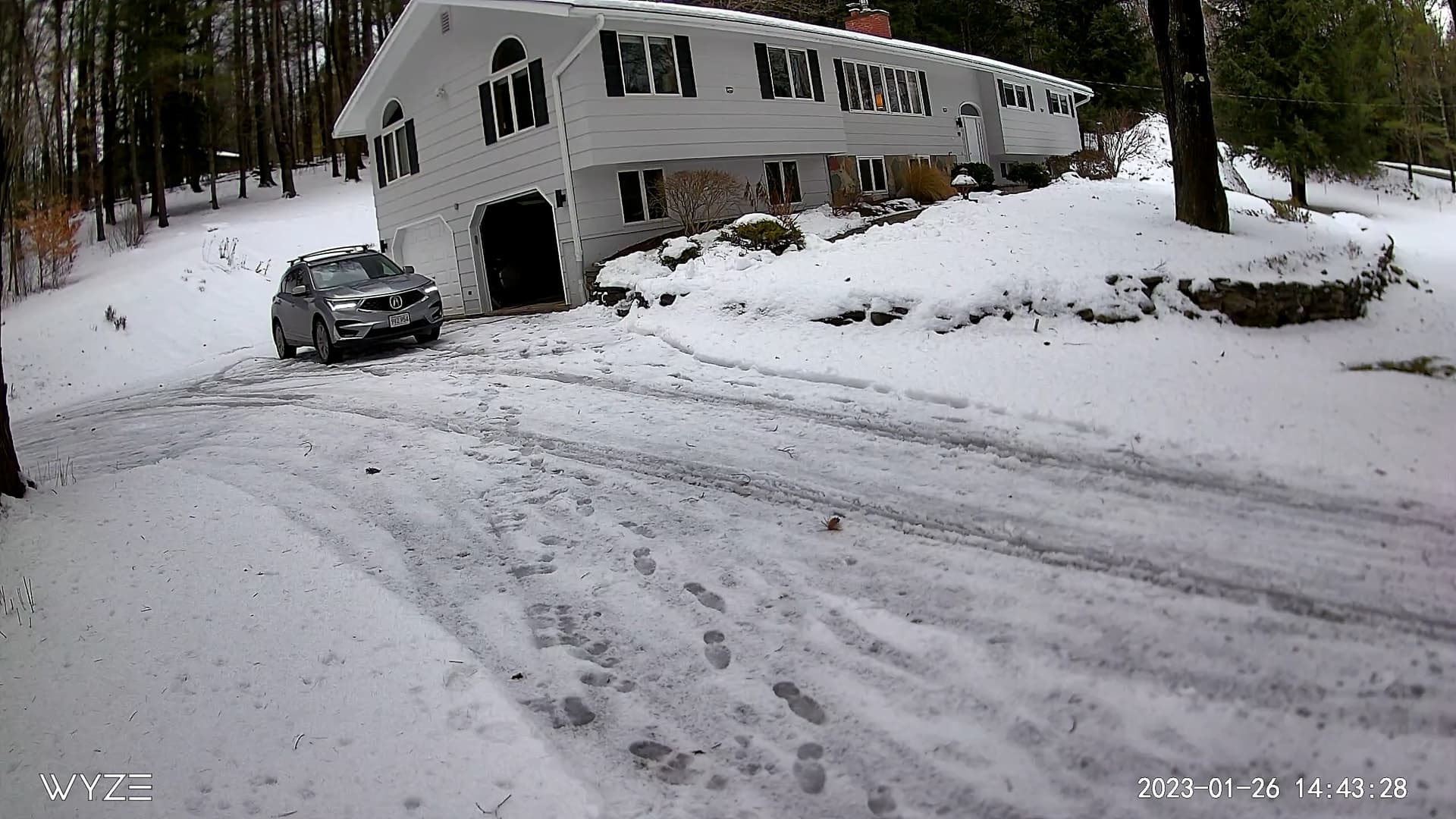

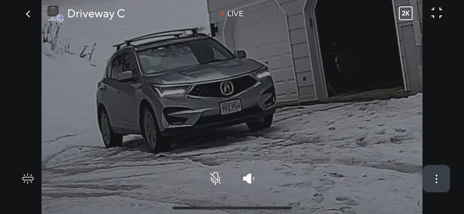

  • IOS App version 2.38.4 (3), FW 4.58.0.3210
  • 42 feet max for 2K setting to read license plate (overcast); 3MP 2560x1440 3.0 MB Jan 26, 2023, 2:43 pm; jpg 861 KB
  • blurry (cannot read) on SD setting; 3MP 2560x1440 2.6 MB Jan 26,2023, 2:41 pm; jpg 776 KB
Note: Other forum topics for the Wyze cam v3 Pro, that are related, challenge whether the cam is really streaming/recording at 2K or less; why the 2K setting is not significantly better in resolution than the SD setting; and what factors determine image quality. Also, previously the v3 Pro was not streaming in 2K with the IOS app (not an issue with Android) and Wyze updated the IOS app which seems to fix the 2K streaming issue, but did the fix reduce the bit rate (which contributes to image quality) for the 2K setting to make it work? More data, like what I am asking, may shine some light on the above.
Update: I added some pictures to support the test results:
- 1st pic is from the Wyze “Take Photo” option in livestream - stationary vehicle is 42 feet from the cam
- 2nd pic is a zoom of the 1st pic to show the license plate - this is an iPhone screenshot while zoomed
