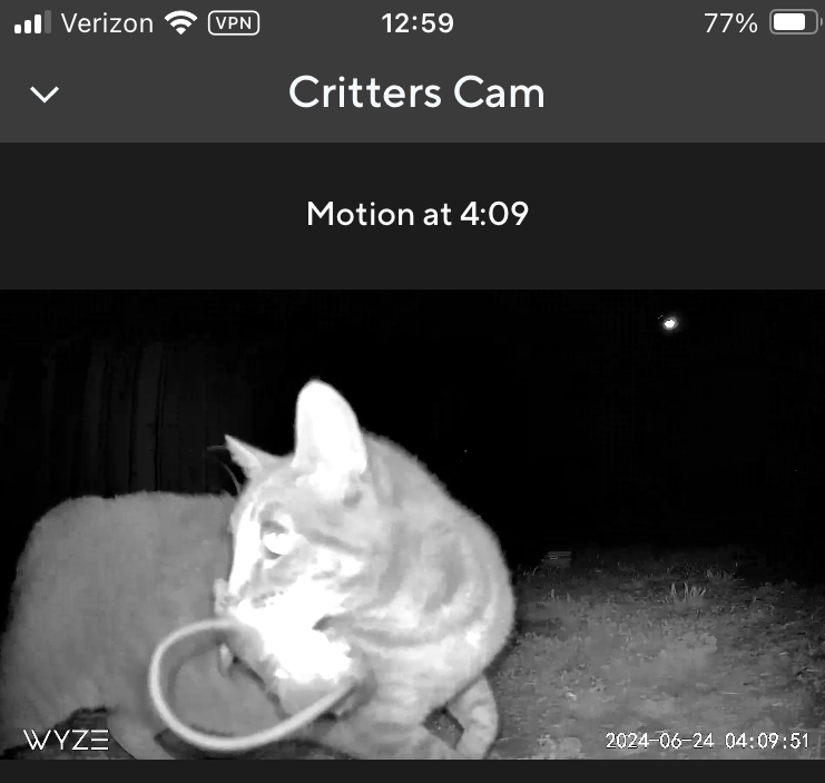

A first for me, a real working cat. I believe he got it in the neighbors yard.The video is tagged Pet on the events page.
