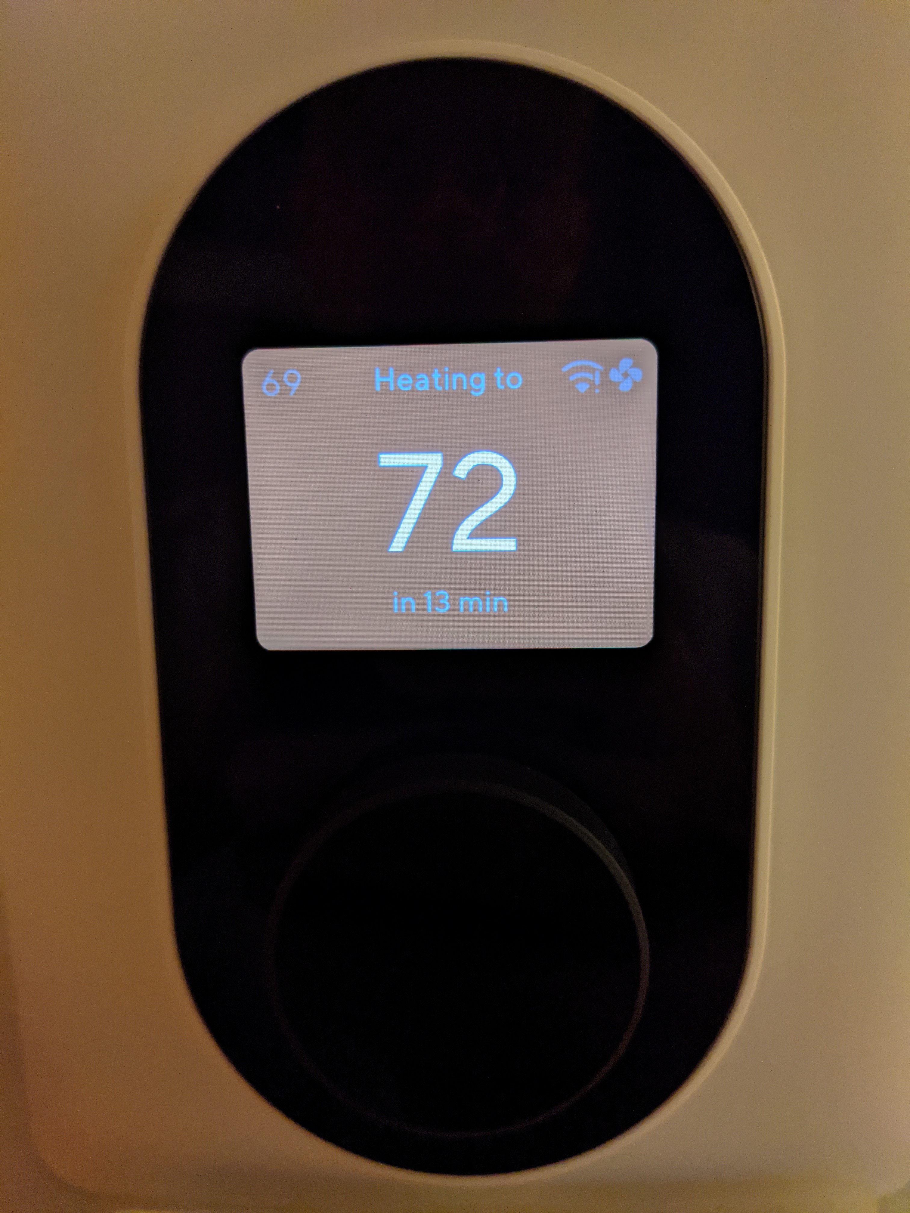

So I tested this morning. 1st I adjusted the schedule so the system would come on 10 min later, then powered off router, then powered off thermostat, left it off for a few minutes then powered back on with router still unplugged. The schedule can’t be accessed from the thermostat itself, but did come on at the correct time according to the schedule I set. So it was a successful test!
Thanks for testing! Good to know it continues to operate on schedule with preset temperature settings. It makes a huge difference for those of us in cold climates that lose power and internet in the winter. One of the reasons why I haven’t replaced my battery powered thermostats.

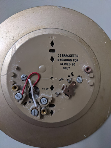

BTW, the compatibility tool doesn’t allow selecting less than 4 wires. I was also trying to verify my boiler thermostat which only has R and W.
This is the one I’d like to replace without having to install any additional wires:
if auto-switch switches to away due to geofence, and the thermostat detects a person walking by, it will switch back to home mode. I’m assuming it’s using the PIR on the thermostat.
Great if the tstat is in a high traffic area, but if you wfh in an office or bedroom, it’s pointless. I had this issue with Honeywell, and nest in the past. Hopefully two people (one with the account email, and the other with shared access, can have geofencing where both need to leave for away to activate. Lutron does this with my lights, shouldn’t be that hard.
Looks like the way my old furnace was wired before I added extra wires for power and fan. Yours is just a heat on or off wiring that when the thermostat calls for heat, it simply connects those two wires together with a switch. The simplest switch used on those is a mercury switch. In order to use a smart thermostat, you would have to at least add power wires from the transformer on your furnace control board.
