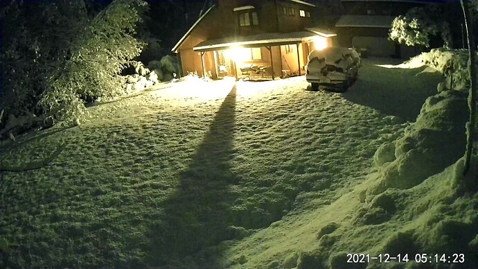

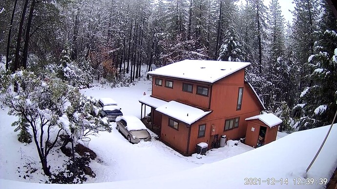

All my V3’s survived yesterday’s rain and last night’s snow :snowflake::snowflake::snowflake::snowflake: So far no issues of fogging or water ingress to the V3 Wyze Cams

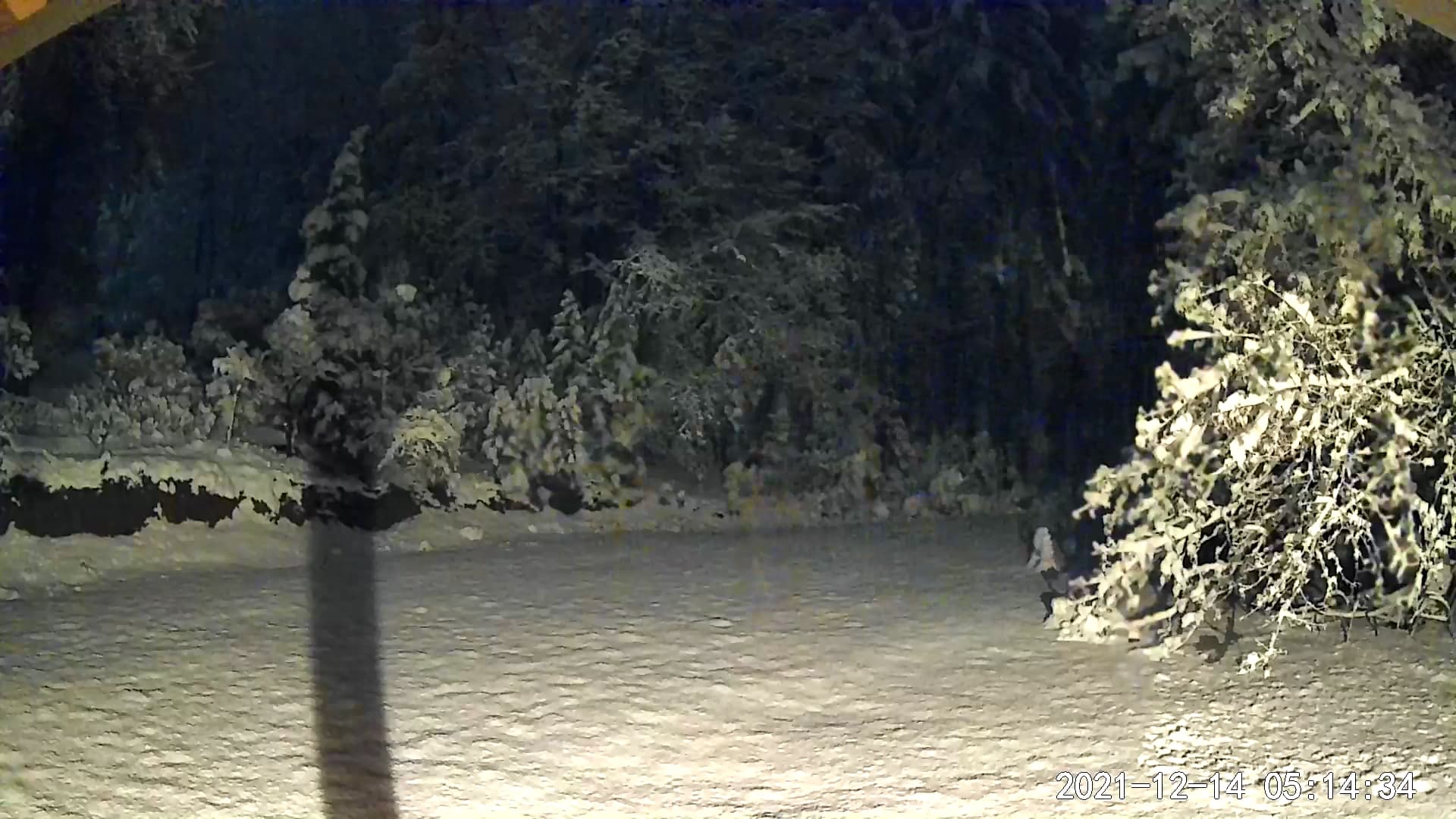

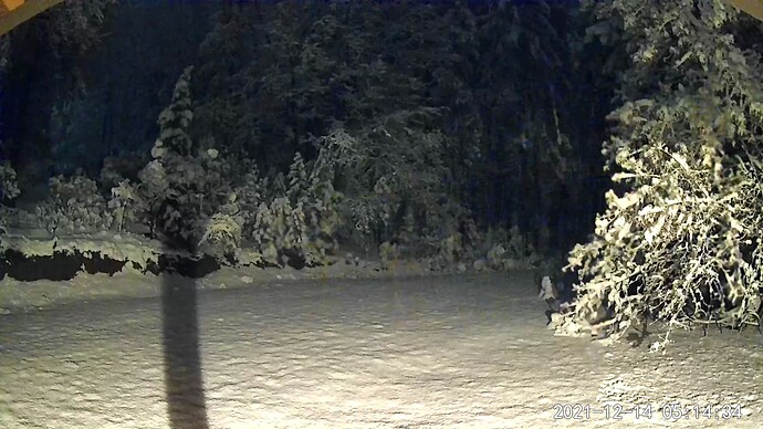

I want to know why the Bear, Fox, Cat, squirrel, skunk or those tasty looking deer are absent. Did thet all go on vacation at the same time? Maybe they took a cruise to Mexico . We got snow here today but on top of Mount Diablo which is only at 3849 feet elevation, I’m at 130 feet elevation. The raccoons and possum did go surfing this weekend though because we finally got some good rains.
All the critters bugged out to lower elevations yesterday :exclamation:
