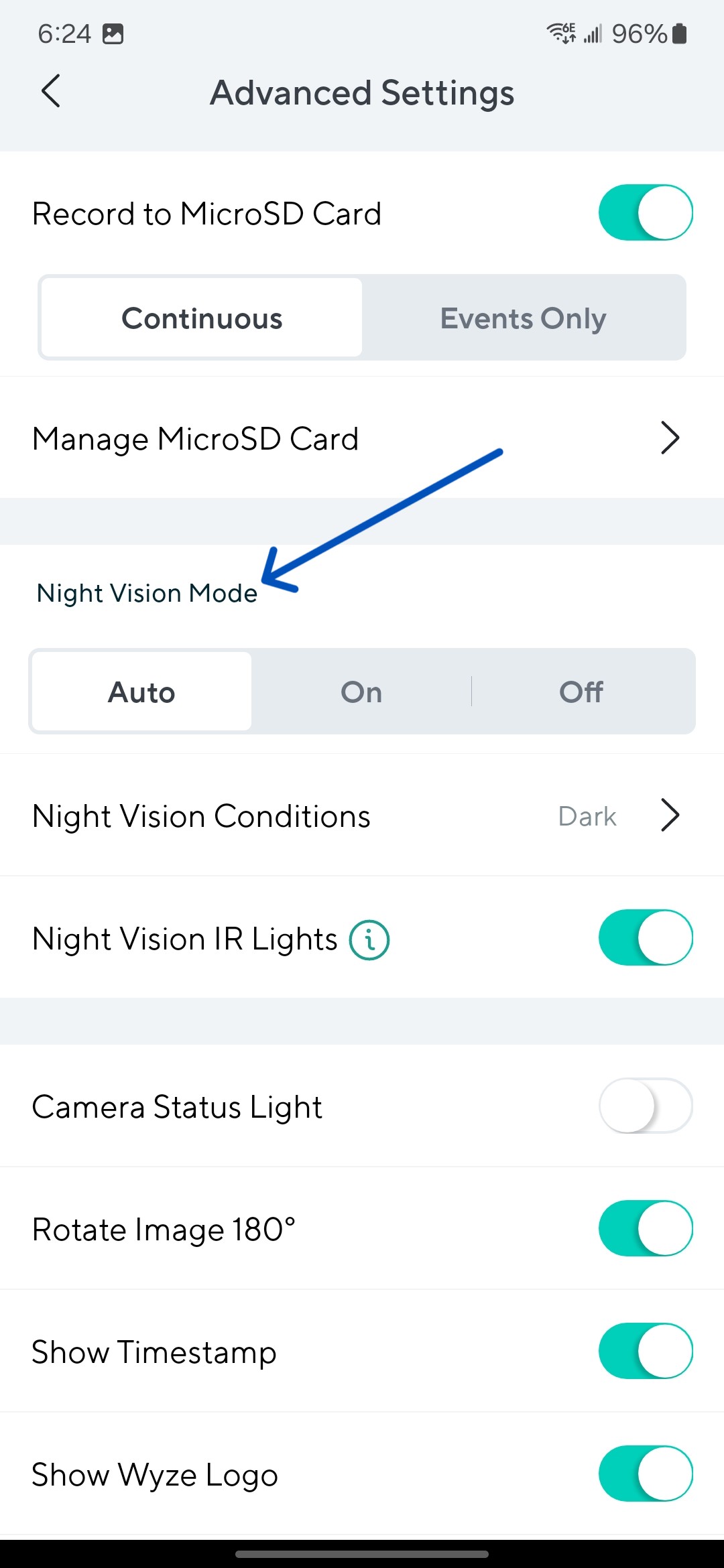

Normally the Black and White implies your camera is on Night Vision Mode.
Depending on the Camera model, you can either turn it off or Auto in different locations:
V3 - on the Main live stream top right will be a moon looking icon. Tap on that to cycle through your Night modes. Note, the V3 also has it in the same location as mentioned below for the V3Pro, V4, and Pan Cam V3.
On the V3Pro, V4 and Pan Cam V3 - you would tap om the Gear at the Top Right to enter settings, then select Advanced Settings. The options are in that menu.
