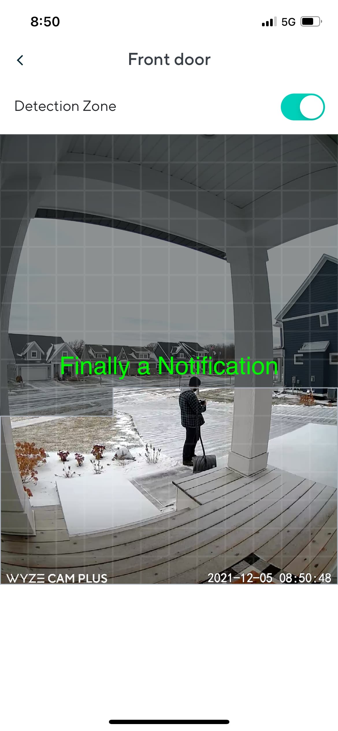

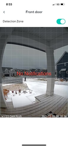

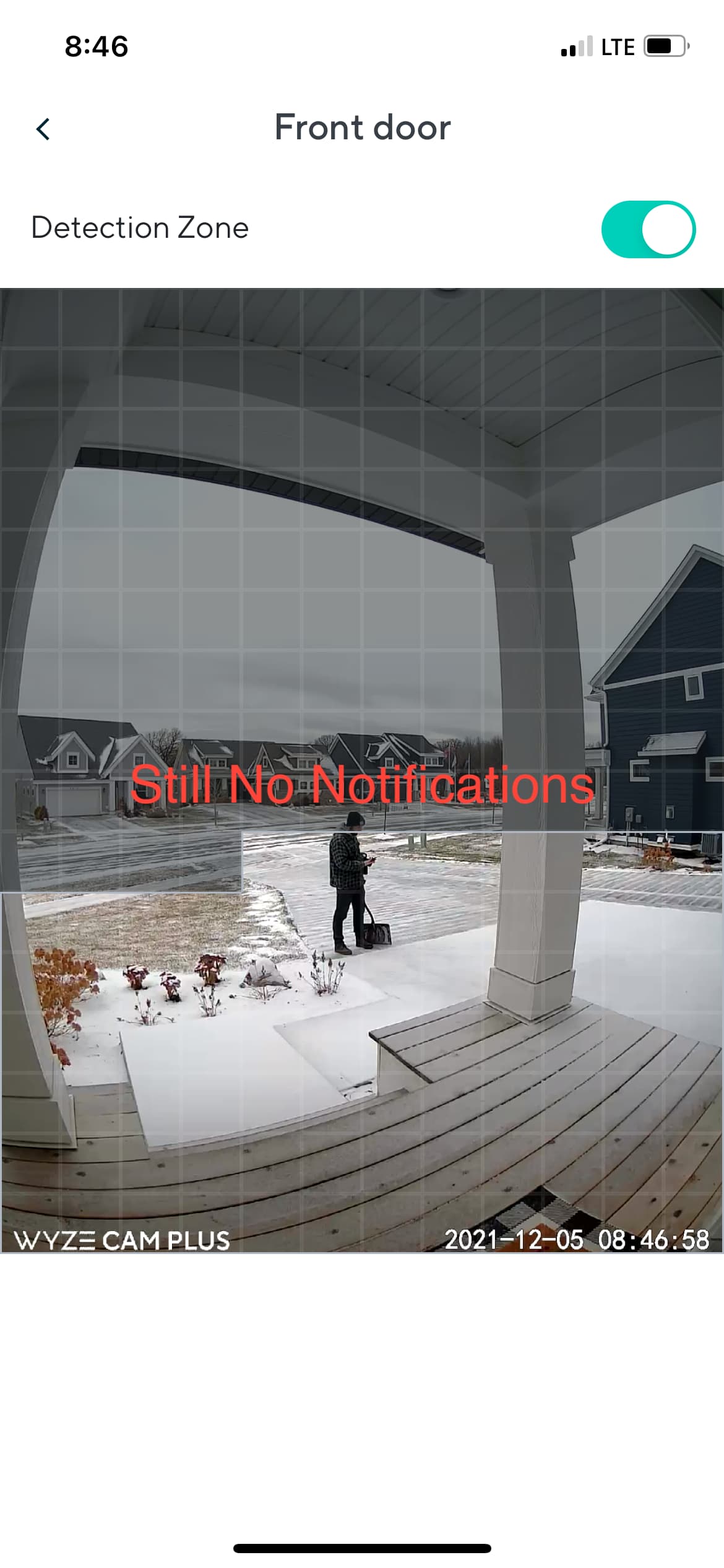

I came home last night and was able to pull into the garage without triggering an alert (you can see the tire tracks on the driveway in the pictures below). I could boost motion detection to 100 but with the 11 notifications I got from snow blowing past the doorbell but not a car coming up the driveway I’m wondering if there is something else I can/need to do.
To help illustrate my current layout I took some screen shots of where I was within the detection zone while shoveling the driveway this morning. I didn’t trigger an alert until I was practically on the porch. Due to forum rules only allowing new posters to upload one embedded media file I’ll have to upload the screen shots separately in this thread
Any help would be greatly appreciated!
Detection is by “pixel change”. So any color, lightness, darkness, any change to a pixel it is determined to be “motion” by the camera. So it looks like your detection zone is fairly close to and still does have some of the road in it. Under the pixel change any headlights, shadows, would be determined to be motion just like an actual car or yourself walking within the defined detection zone. The reason it doesn’t alert until you get close I believe is possibly the sensitivity settings. If you were to up the sensitivity settings then make your detection zone start farther away from the road I think you’ll have more detections of actual stuff in your driveway and walking up your house. This would also exclude some of the headlights and other pixel change near the road.
Hey @Omgitstony
Thanks for the explanation on how detection works, that makes sense. I’ll tighten up the zone and boost the sensitivity further and see how that works out. Appreciate the quick response!
