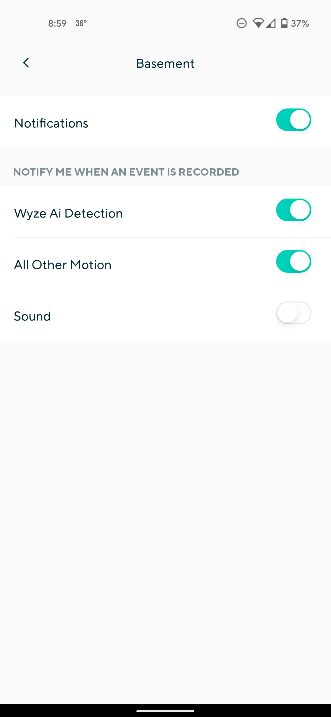

Swapped out 6 v2s/pans today with v3’s and I notice there’s no person or AI push notification filter. Only options are motion & sound.

What I’m referring to is selecting push notifications for only person or AI events instead of all motion. The v3 does not have that option, so I’m getting a push notification for all events.
In your screenshots, which cam types are Garage and Basement?
Garage is v3, basement is pan.
I got it figured out. I had to remove cam+ from the v3s that only had the motion notification option. After I added cam+ back, I had the AI & all other motion options.
