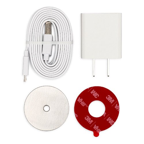

You can replace the power adapter by using what you have - 5V 1A minimum, buying the Wyze Kit below :anxious_face_with_sweat: if it is in stock, or you can buy your own just about anywhere… like Amazon. I bought a half dozen dual USB A\C power adapters pretty cheap.
