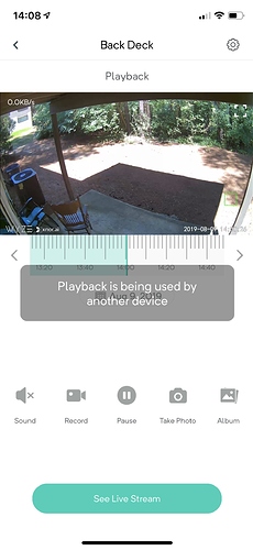

Is this what you are seeing?
Only one person can access the SD card at a time. I live alone, but just calling up playback on the same cam on 2 devices at the same time will generate a message that playback is being used on another device.

Yes that is the same message that I get. Now how do I figure out who is viewing my cameras seeing as I am “The Owner” and have not authorized anyone access.
See if it is still happening. Can’t imagine why someone would be camped on your SD card. My guess is you had playback up on 2 devices when you saw the message.
If you still see the issue, unload all Wyze apps on all devices, and power-cycle the camera.
