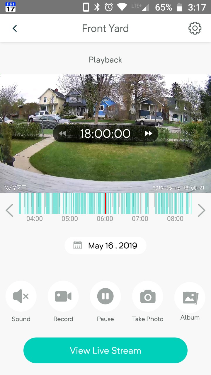

The time index in playback shows AM and PM the same, contradictory to the time stamp.
Time stamp is in 24 hour (eg; 16;22 / 21:45 / 07:33 etc) whereas the index used in playback shows 07:33 when it is 7:33 PM when it should show 19:33 and AM and PM not indicated. Sometimes it is frustrating to locate the correct time using the index.
There is also an overlap of time stamp information when the time index is visible in playback in landscape mode. The time index effectively overlays the timestamp on the screen, very difficult to read.
See uploaded screenshots

What they have now is just a programm error. It isn’t 24 hr time or am/pm.
For example - 8:00 am or 8:00 pm appears as 08:00. 1:00 pm appears as 01:00 not as 13:00. It’s is just messed up programming that hasn’t been corrected in over a year.

No I am not asking for am/pm markers in the timeline. I just would like the bug fixed in the timeline.

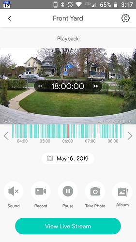

Did you look at the screen shots I attached to the original post? The last photo I attached shows 18:00 but thr time line indicates 06:00.
Now that you pointed out if I switch my device to 24 hr time it corrects this error. I don’t want my phone on 24 hr time, just so I can correct a time line bug in the wyze app.
Why does it show 18;00 on the screen but 06:00 on the time line.
That is a bug.
Yes
It’s a bug. When phone is set to 12hr time, the time display on the footage should show 12hr time and the timeline should reflect 12hr time with AM/PM indicators.
