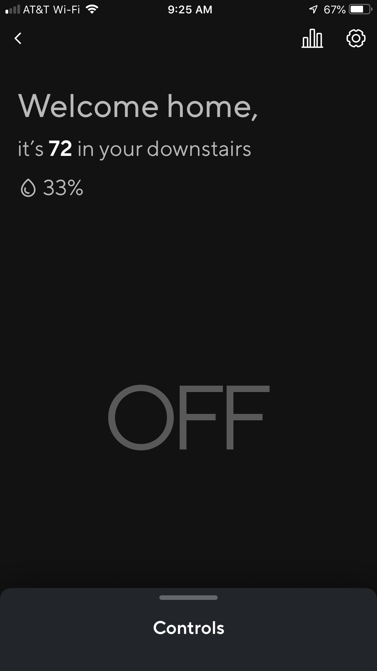

Woke up this morning and the heating was on and the temp in the house was 71, the thermostat should turn off but did not. I changed the setting on the app from auto to off, and it did not change. After waiting a long time, hoping that it was slow… The temp in the house is now 72… I decided to run the “System Test” and that test operated correctly… The heating was already on and the test turned on the AC and I finished the test. After what seemed like 5 minutes the AC turned off.

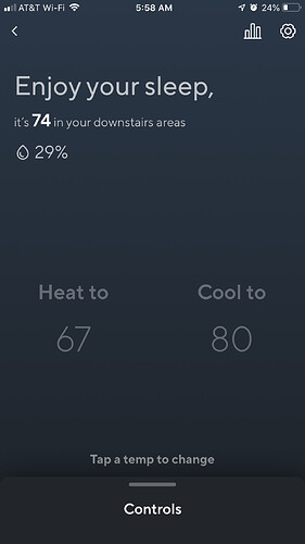

Yup this happened again during the night… should have turned off after going above 67… didnt turn off until 74 degree was reached.
