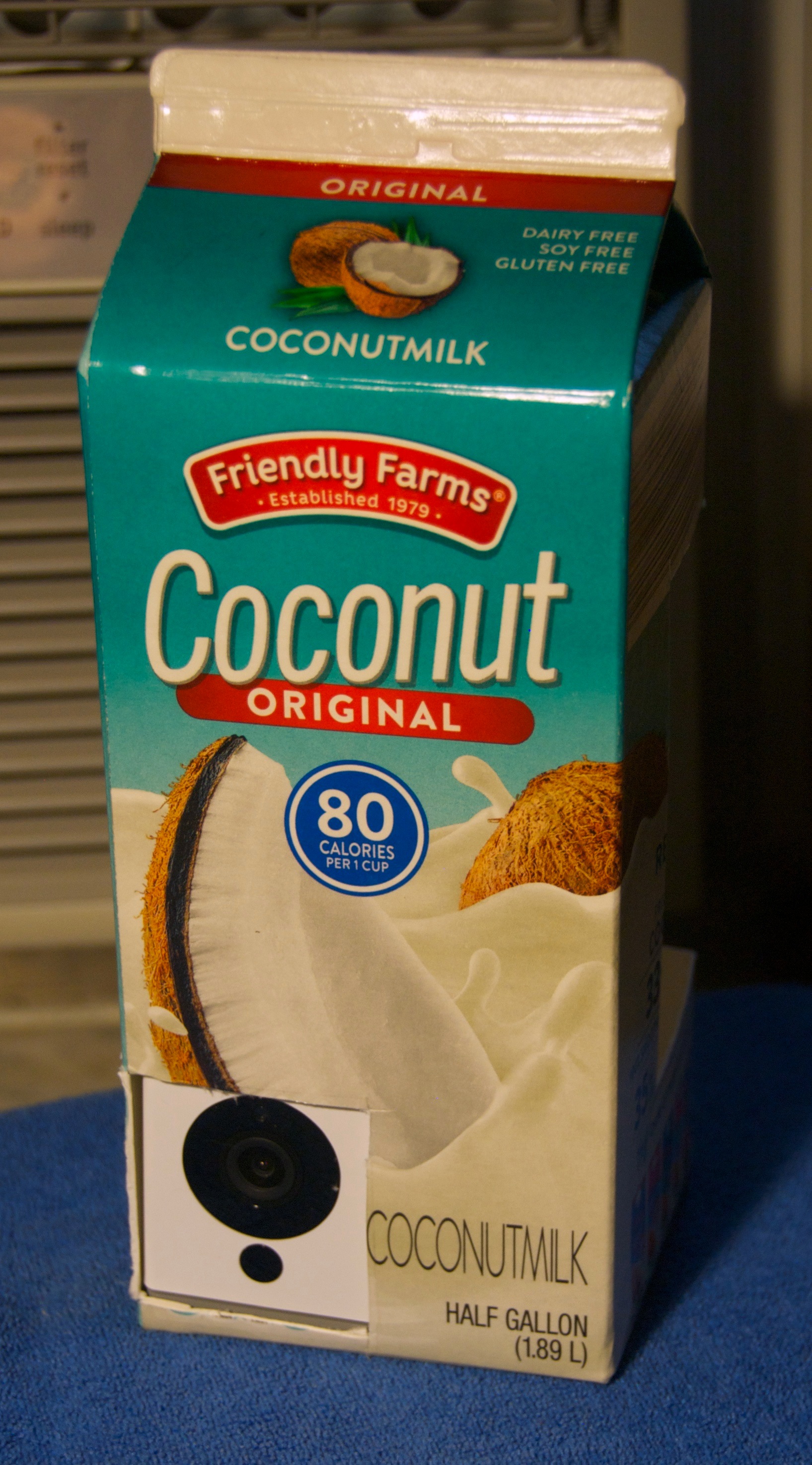

Stealth WyzeCam
We decided to try camouflaging one of our new Wyze Cams.
This is one of the ideas we tried and wanted to share it with the community.
We know it’s not the greatest but it is better than a camera just sitting in the open which can be easily spotted. Maybe on the next milk carton we’ll take a little more care cutting out the hole. We also cut a large hole in the rear to allow for placement and for the excess wire to be bundled inside if necessary. We placed it near an electrical outlet.
We have gotten a lot of great ideas from others on the forum so far as placement and various ideas of what to do with our WyzeCams.
We would like to see other people’s stealthy ideas for concealing their WyzeCams.
Thanx,
73’
Tuna

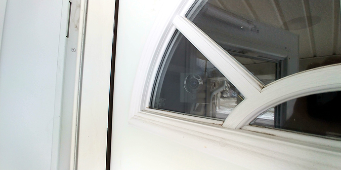

so there is a guy on here that is experimenting with vinyl wraps for the V2. I bought some off of him and they are great. I didnt line up the edges perfectly but it changes the cameras visibility immensely.

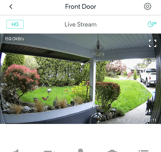

and here you can see the one I have looking through my front door. with the wrap, unless you are looking for it you would never see it.

Yep, thinking that too, But, it’s not milk per sae, like cow’s milk that would sour and become smelly cheese type milk. It’s coconut milk and I’ll have to leave some out to see exactly what happens. Anyway good point. But, we had an empty coconut milk carton and said hey, it’s recycling bin material so, let’s give it a try as a test bed type of deal. We could be the type of people who leave our empty coconut milk carton on the counter because we were in a hurry to get to work that morning! Hiding them behind clocks, portraits, pictures, mirrors and all sorts of ideas have come to mind. Yes, the front door with vinyl wrap looks good. You can hardly see that black wrapped camera behind the glass even with your reflection on the glass. If you had dark curtains or a dark upper corner on top of the curtain rod. Also behind the glass in your entertainment center watching the people watching TV, hey now there is a concept. On top the refrigerator, or on the counter top, different containers in the kitchen would work nicely as well. Something that is not out of place in the kitchen, or living room. Use an old answering machine that does not work anymore wires and cords running to it are normal and do not look out of place, a stereo, speakers, Pretty much any old device that has wires, or had wires is a good choice since the wires will not be suspect and can be left right on a table or shelf in plain sight.

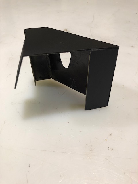

Proto Type #1 for my ring cam.
Nice job. For future reference, the 1/4 inch black circle under the main lens isn’t connected to anything, so you can cover that and not have any white showing.
I assumed it was a light sensor.
Instead of fabing a new housing just use some electricians tape, etc to cover up the white part. How’d you run the power wire?

I already have a new housing laid out on the Micarta ready to snap so I can redo that cutout.

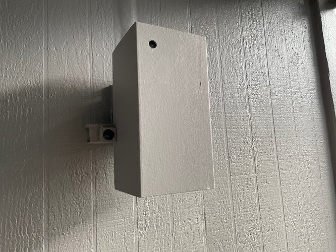

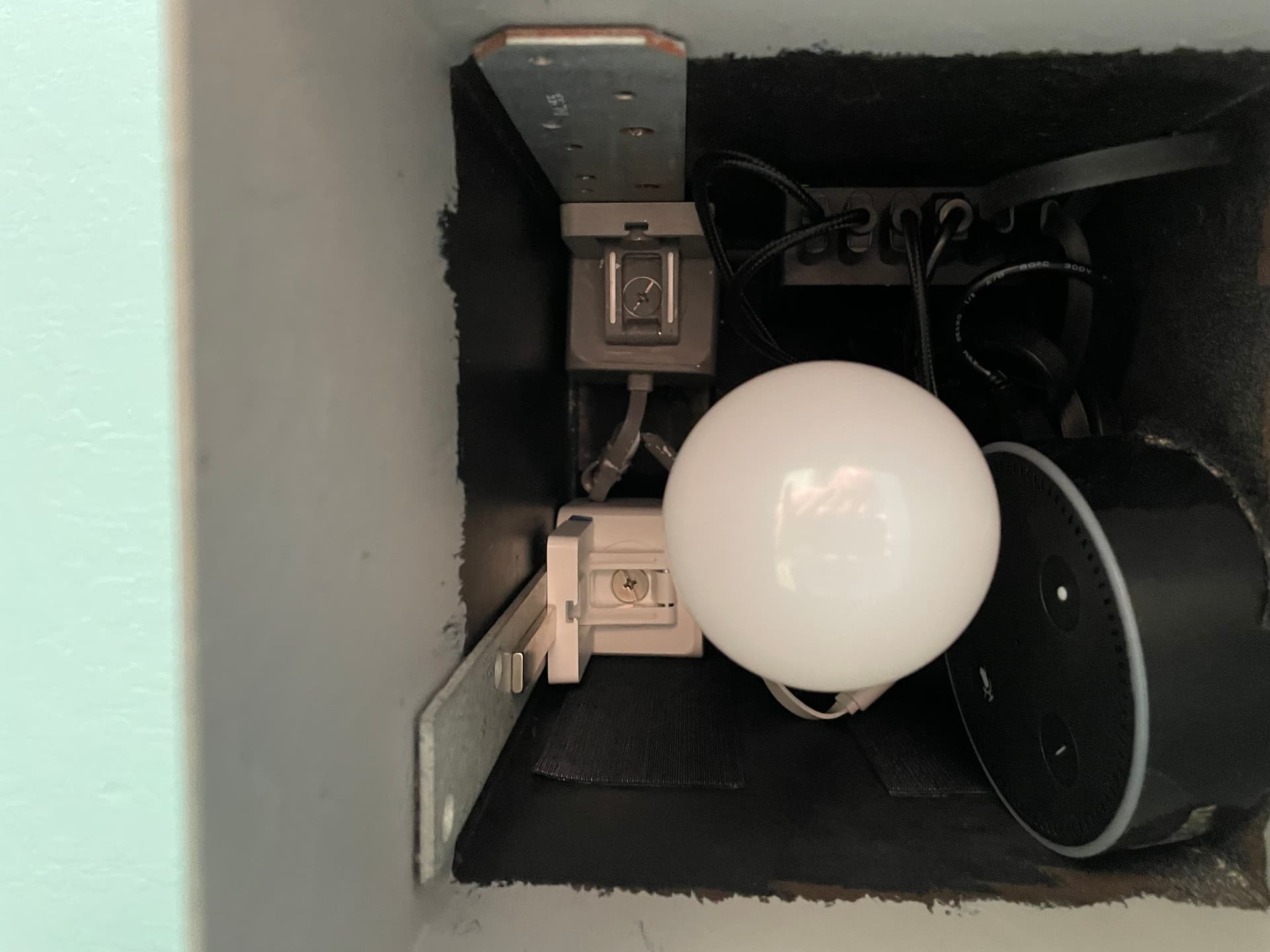

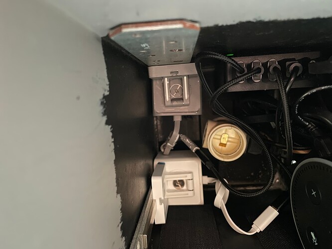

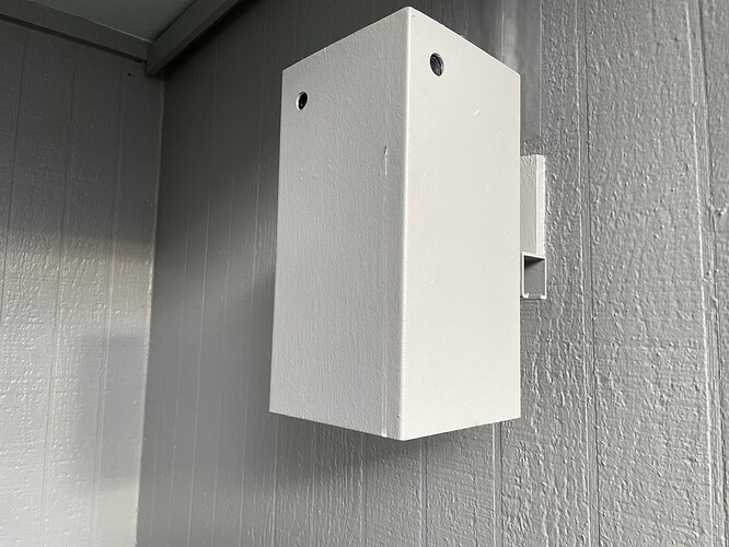

Hidden Porch Light Cameras
I have a rectangular box like porch light. It has one A19 standard bulb socket. So, I used it to power two Wyze V3, an Echo Dot, a 6 port USB power brick/110V and a Wyze bulb. All that stuff is stuffed up inside the box from the bottom. Oh, and there also two grey flat 10’ USB cables running outside the box, up the wall, (covered by duct tape & painted to match) along the porch ceiling to two more Wyze V3’s (not pictured).
The light exterior has two 5/8” holes drilled about 1.5” from top and side for the camera lens to appear. The exterior is aluminum and would not hold the camera base’s magnet. I tried Velcro and double-sided tape, but I could not adjust the cameras’ position to insure max view. So, after several bad choices, I found some hard steel strips and used Gorilla double sided to attach them to the inside. Fortunately, the slight offset of the camera base folded straight down made it fit flat against the drilled opening. Perfect. (One of the V3’s was painted with grey paint before used inside the light.
The power brick powers four Wyze cameras and the Echo Dot. Velcro holds the power brick and the Dot in place. Big enough pieces of Velcro make it difficult to get them out when I need to do something. So, they stay put.
In one porch light picture you can see a Wyze Sense V1 painted to blend and on the leeward side of the light, so no one notices it. This triggers Alexa Routine announcements inside the house for Alexa routines displaying the two light V3’s on a Echo Show and a Fire tablet. Behind the light on the wall, there’s a strip of duct tape up the wall covering two flat 10’ cables going to Wyze V3’s mounted at the ceiling height. Powered from the brick inside the light.
The porch has this light and a recessed light above the doorway. Wyze bulbs in both because the light sockets remain powered all the time. Easy to reset the entire mess just turning off the porch power in either the inside hall or the garage.
From the view inside the light with the bulb, one of the metal strips has a long narrow magnet under the Wyze camera base. That base magnet is weaker than the other. The magnet keeps the camera/base in place.
The Wyze bulbs on the porch are turned on and off from a Wyze contact sensor mounted on the garage door triggered via an Alexa Routine and turns everything off in three minutes.
The insides of the light look like a sloppy mess, but they are out of sight and everything works and stays in place. Handy having an Echo Dot on the front porch – out of sight.
