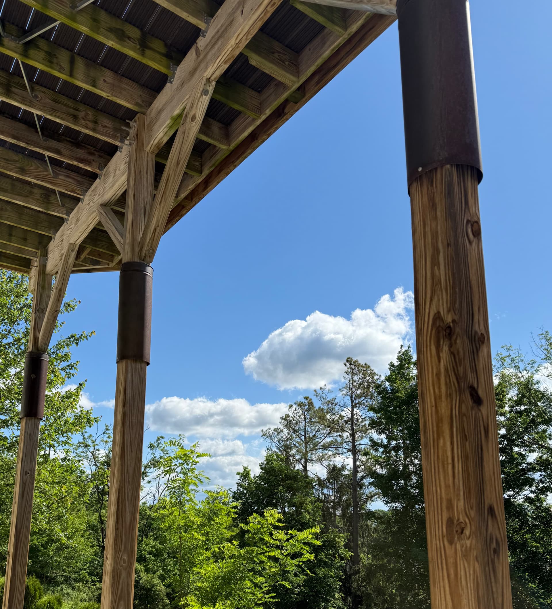

I was out of town, but here is the system.
I have 6x6 deck post, They make circular squirrel guards (cones) for 4x4 post, but I couldn’t find them for mine. Also the cones for a 6x6 would be 30 inches in diameter and look awful. So I went and got three 8” single wall stove pipes and 3 caps. I drew a 5.6 x 5.6 inch square on the caps, and joined the diagonals and cut leaving 4 triangles attached. Then cut off the tips of the triangles and bent them inward. Then cut a slit in the cap at one corner of the drawn square to facilitate putting it around the post. The caps were then attached via screws through the triangles to the post. The top was caulked at the post to prevent water intrusion. Then the stove pipes ( which come flat with a pop together seam were wrapped around the post and with some squeezing I got the seam to lock. Then slid the pipes up and over the cap flutes and attached with two screws to the caps. The bottoms of the pipes got two screws ( not tightened ) just to keep them centered and round. They have been up for 10 years or so. The squirrels tried for 2 days to leap from one post to above the sleeve, climb into the sleeve and on the sleeve. They can’t. These could me made for 4x4 post also using the same 8 inch cheap stove pipe or go down to 6 inch pipe. 2x per year I saturate the post / sleeves with home perimeter bug spray and haven’t had any problems with any nesting inside the sleeves. I believe some if that is due to the sleeves get very hot in the sun and it’s not a great place for bugs to build.
It would cost about $20 per guard to make today with a Pipe Cap and a 24” section of stove pipe. You also need some tin snips or a dremel / angle grinder w/cutoff wheel to cut the X in the cap to make the triangle tabs and some outdoor sealant to caulk the caps to the post. This is the weekend project you didn’t know you needed - get to it.
