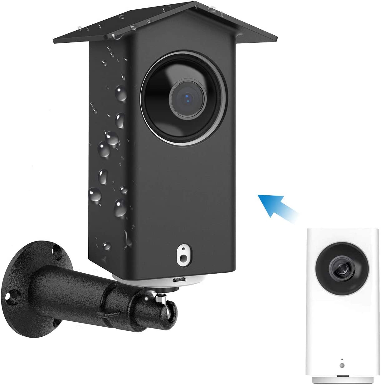

I did listen to the Google post and the sound I heard from that is what I have been used to since my first pan. As I am writing this one suggestion does come to mind. I have a pan in a protective ā€œOutdoorā€ cover, basically just a silicone glove that covers he cam and it does mute the sound from the cam considerably. Might be something to consider.
thanks, at least I know im not going insane and there is a difference in sound. I think the difference is Im not use to the sound it makes (just got the device so it is very noticeable). If you have lived with it for ages you probably wouldnt notice it.
I might try adding a cover over the device and see if that helps, I was wondering if I could add some kind of casing in order to help muffle the sounds.
