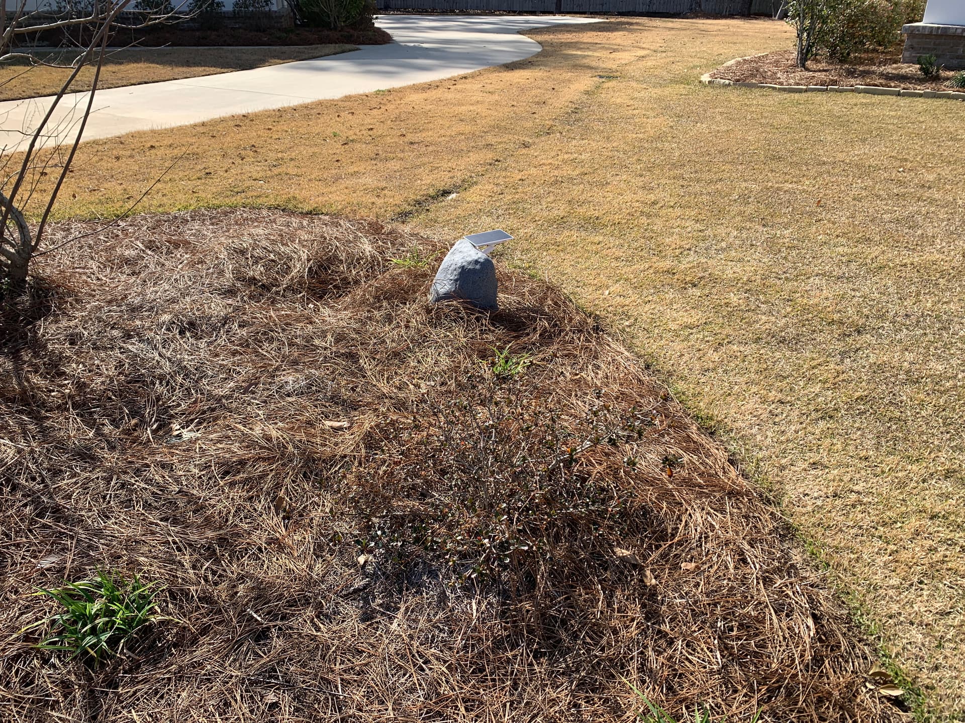

I hooked up 2 more solar panels. One of the cams is on a tree, the other is hidden in a fake rock - which with a solar panel on it is no longer cleverly hidden! Once again, the cams are charging nicely and I expect they’ll always stay “topped off” near 100%.
This guy could find your in-the -rock cam without the solar panel. :grin:
