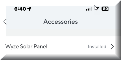

I never gave any thought to this toggle for the Wyze Solar Panel until you referred to it in your message. (I too just installed solar panels on my WCO’s very recently)
If my WCOv1 w\solar does drain significantly faster than the six non solar connected ones, I’ll then do the test and set myself a reminder to toggle this off each night around 6pm and back on around 2pm. (too bad there’s not an automation that was available to do that for me)
