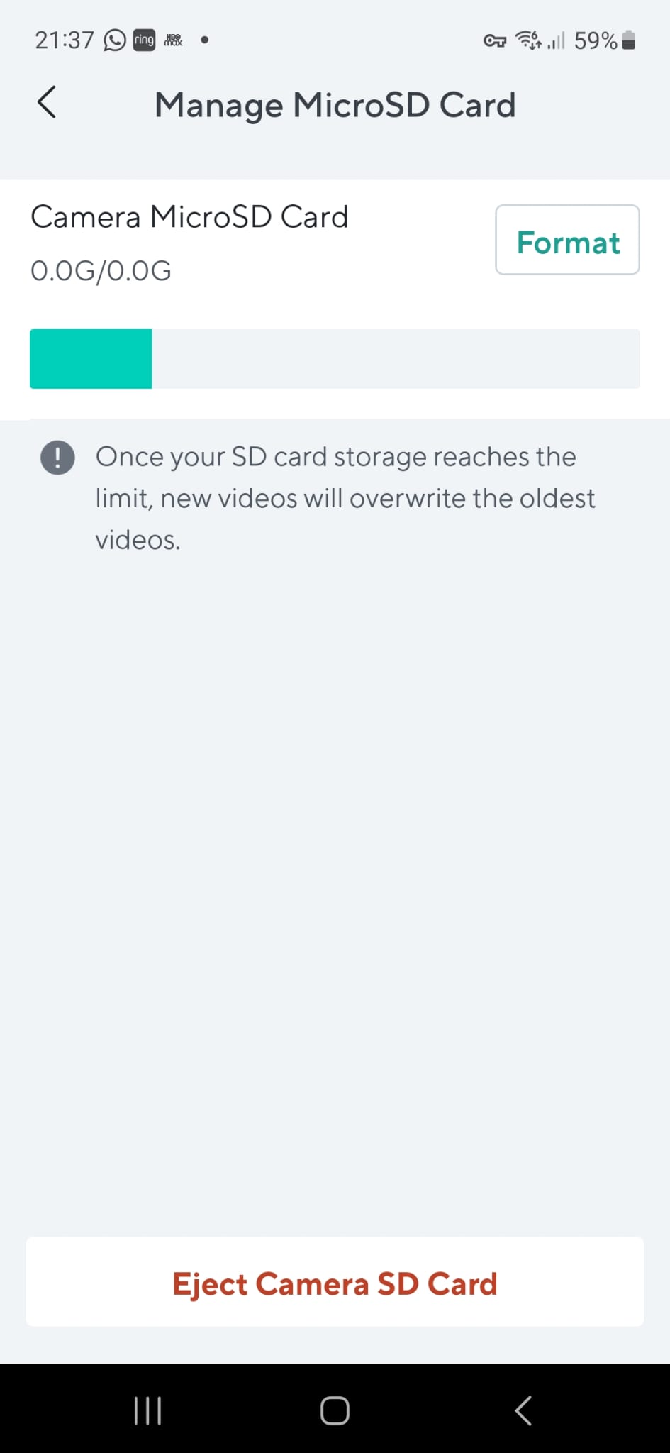

When I put it in the cam i hear a ding-dong indicating that the card is inserted, have formatted it on a windows pc on fat 32 but when I press the sd card button in main screen it says that there is no card present.
When I go to settings, avanced,The Record to Micro SD Card switch is enabled by itself and on continuous recording, I go to manage SD Card and it says 0.0G/0.0G.
I do press format, i do have to hear another ding dong but everything keeps silent.
It says formatting, but the result stays 0/0.
Then back to the main screen,press on the sd card button, it says loading sd card and voila, there are recordings and the card is recognized.
But still the size is 0/0
What is wrong here ?

Thanks for the reply, tried it, but the result stays the same, the camera does record, you can see the recordings, but the info keeps saying that the card is 0/0,no size and no bar telling how much space is left.

I took my old apple, see the differents, this is my apple: ( 2.41.5 (5) ( Iphone 8 ios 16.4.1 (a)
This is my android S21-FE (android 13)
So for some reasons the bug is not in the camera but in the android app ?
I did all those things for nothing ?
