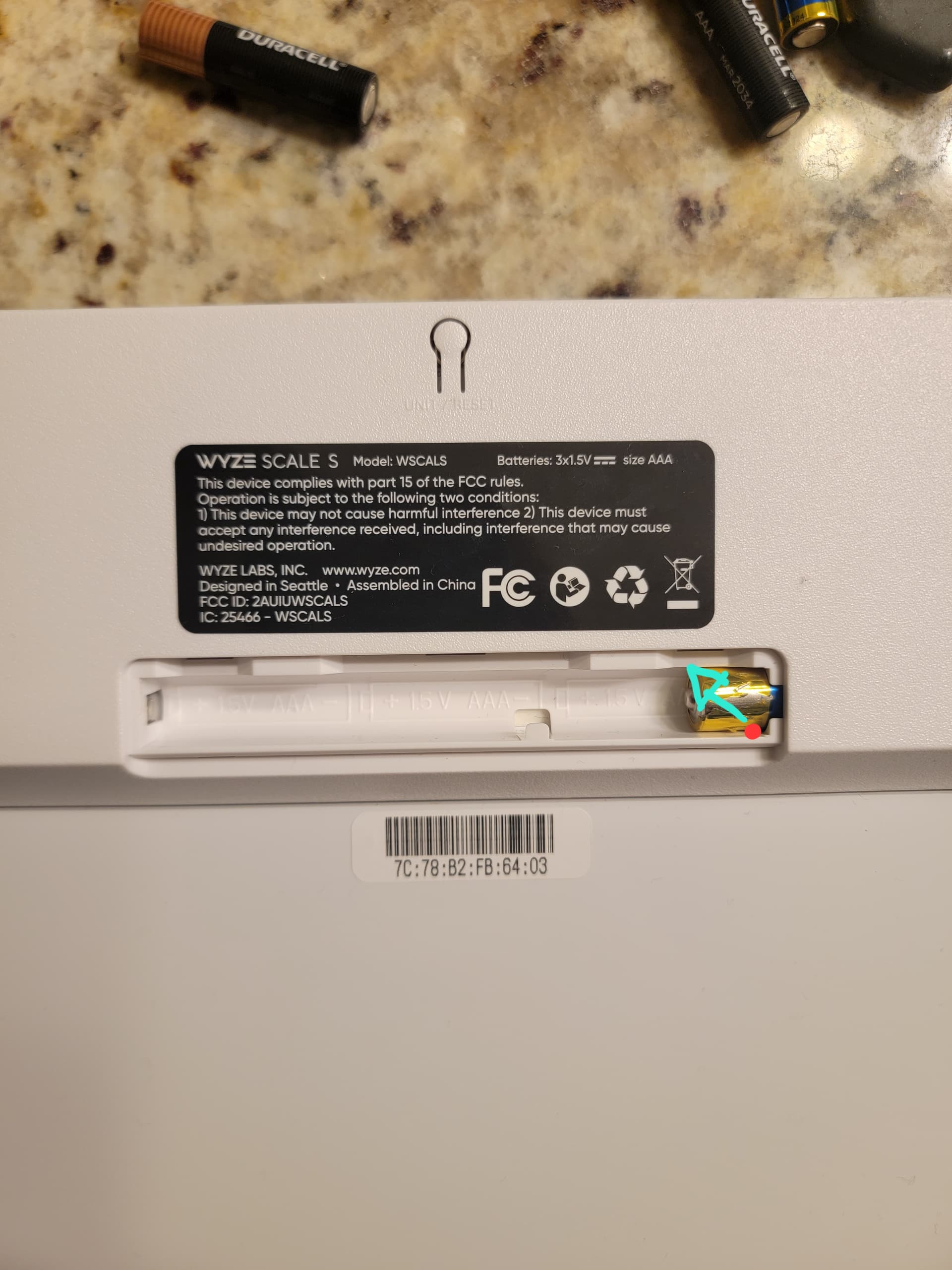

Figured it out! Use a pocket knife, use your left thumb and right hand with knife.
Stick pocket knife in red dot and use left thumb to push out to the top. Slowly!! Took less than 3 min.

One more person with the stuck battery. I appreciated all the pictures in this thread. I tried needle-nose pliers. Ha. I even found a tool in my husband’s toolbox that looks like a dental tool with a very sharp hook and thought for sure I’d found a solution, but I couldn’t stick it into the battery deep enough to stay; it just slid off while deeply scoring the battery. That end of the battery now resembles a battle zone. I saw the recommendation to rotate the battery, but it was too stuck to even budge with any tool I had. The superglue idea was great so I tried that next, but stupidly tried to put the superglue on the battery, not the fabric. I have now superglued that battery into my wyze scale permanently. I’m very sad that I have ruined my scale. And quite annoyed that wyze designed a scale without full access to all batteries.

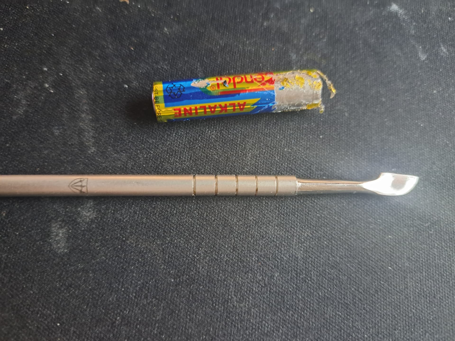

I used a cuticle pusher and wedged it into the side so that it is squeezing the side of the battery against the plastic. Then I pulled the cuticle pusher along with the battery out of the opening. The friction provided enough grip to force the battery out.
