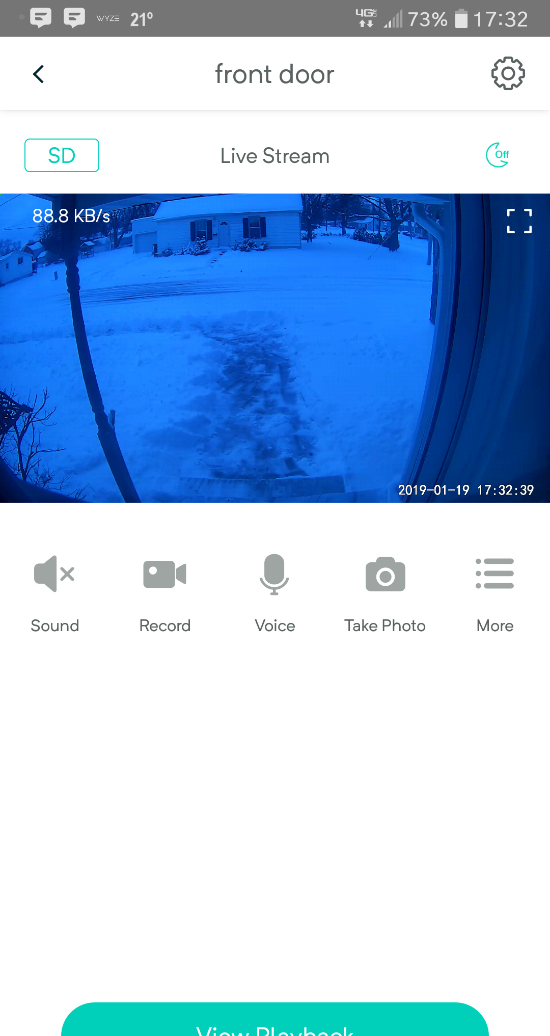

did we ever find any other solutions to this? mine is having a blue tint to it, but its only at certain times, the other day it happened in the morning with grey skies, and today in the evening…cloudy again…it fixed itself though. i didnt adjust the camera at all. its only happened on this one camera though.
There were a few diff issues that may have caused this:
  1. Firmware: Old firmware may have had a tendency to have the blue/purple shift under some lighting conditions. Current firmware should not have this.
  2. Magnets: Early cameras seemed to have magnets that were too strong and affected the infrared cut-off filter which was electromagnetically moved for daytime/night-time mode (the clicking you hear at night). Those were replaced by WyzeGuys
  3. Weird ass random blue color on current firmware and with base magnetic stand moved as far away as possible from body and camera shaken, tapped and rebooted: My current situation with 2 out of 12 cameras. No idea why and will likely file a warranty repair/replacement claim.
The blue isn’t a HUGE problem but it looks annoying lol.

Very similar issue this AM. Flat light, grey sky, snowing. Back to Home Page, then Live View. Normal screen. Clueless to why. Will worry about it if it becomes a reoccurring issue.
hey @kimcheese2017 I’m thinking this is just a pickup issue where the camera and the environment are right in-between two options such as adjustment for night vision or regular vision. I don’t remember now If I tried switching modes. did you by chance try switching night vision on and off to see if each option had an effect on it?

Checking today’s Playback. 0648, the first recording of the day. For the first ~25seconds had the blue tint. Started transitioning to normal as a motion tracking box slowly opened and expanded to the size of the set Detection Zone. Not sure what motion was even detected to set off the record process. None of the other Playback clips had an issue. Weird.
Might have a reason behind my blue tint screen. Happened again yesterday morning. Again the first event recording of the day. Not this AM. No event recording today. Difference was a clear sky at sunrise this AM vs. flat light cloudy sunrise the previous two AM.
The Guess: Both blue tint episodes event recordings began ~2 minutes after sunrise. The v2 Night Vision mode is set to OFF. When a critical level of illumination was reached an image was captured by the image sensor. The black live view to the initially blue tint image. The change in natural lighting triggered the detection zone box and triggered an event. As the natural light from the rising sun increased it allowed the green, red pixels to kick in resulting in a “natural” scene. Blue pixel sensors most sensitive?
