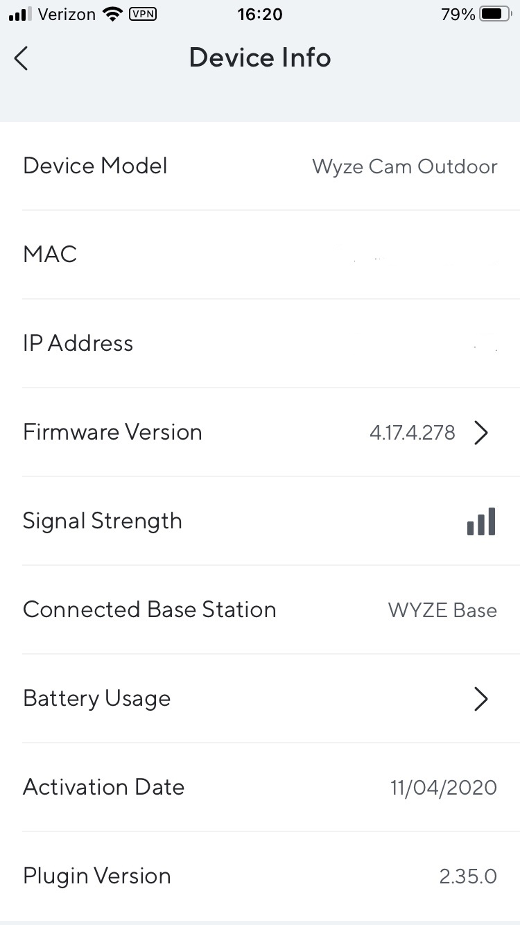

I’m using all the same firmware on the base and my 4 Version 1 WCO as you are without issues so I don’t think it is a firmware issue. Have you checked the signal to your cams on the app? Here is my base and one cam. I just moved the backyard cam 30 min ago and guess I screwed up the signal, it’s had 2 bars for the last 23 months :astonished:
