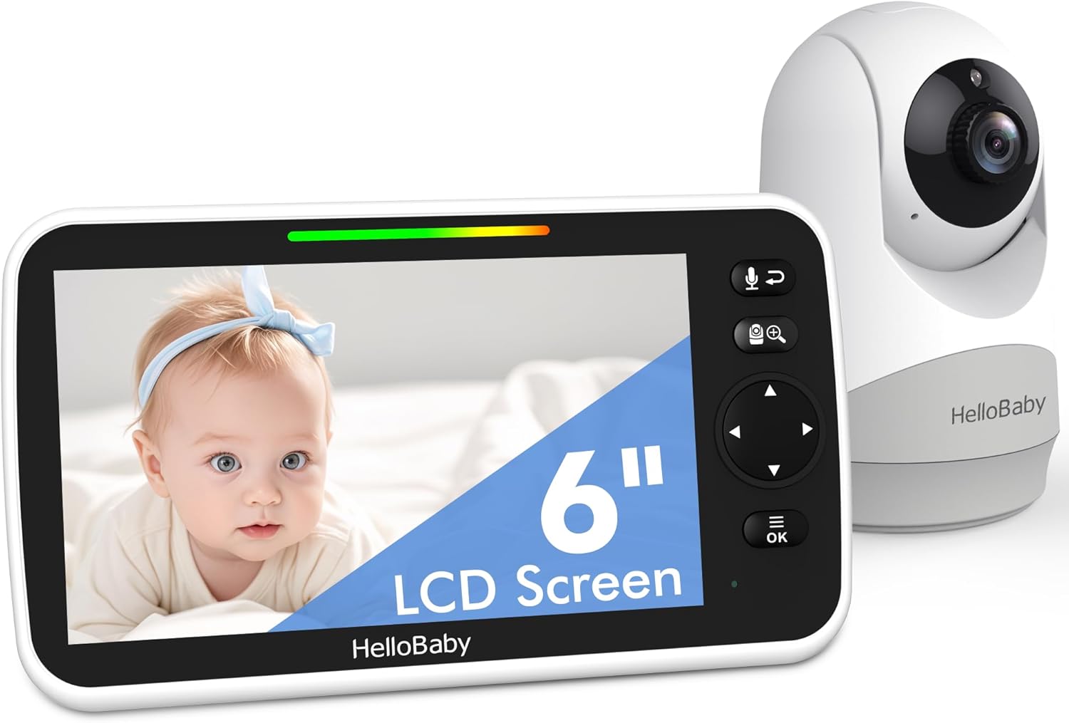

Here is a solution that may work for you. What about a baby monitor camera looking out an upstairs front window? I just bought a Hello Baby brand for when my 11 month old grand daughter stays at my house.
Even though I have WiFi in my house the camera connects directly to the included monitor/screen and no WiFi needed.
My grand daughter sleeps in an upstairs room while my wife and I are downstairs. The unit works great and your budget can determine the screen size.

I have a feeling that @StevenA 's suggestion might be your best bet as long as you don’t need to stream more than one camera.
