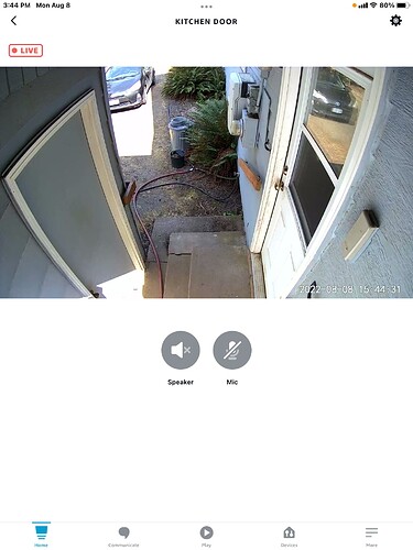

This is a v3 via Alexa:
I have several V3s that with person detection turned on - in Alexa. When vehicle or persons are detected, a routine displays the image on an Echo Sow. About 1/3-1/4 the time, the Show reports, something is wrong. Well, I have all on WiFi switches. So, I off/on the camera via the WiFi Switch and then it works probably 90% of the time.
Well, this gave another thought. My WiFi switches have a scheduler. So, I set them up to each off/on at 3 a.m… This reduced the times I had to single one out to off/on it. Hmm, then I thought, make a routine controlled via a voice called routine that off/on’s them when I call the routine. I used the wait command an spread the restart out with 3 minute intervals, with a voice alert when its done.
If I wasn’t so lazy, I would write myself up an award and a Tootsie Roll lollipop for being so dog gone clever.
