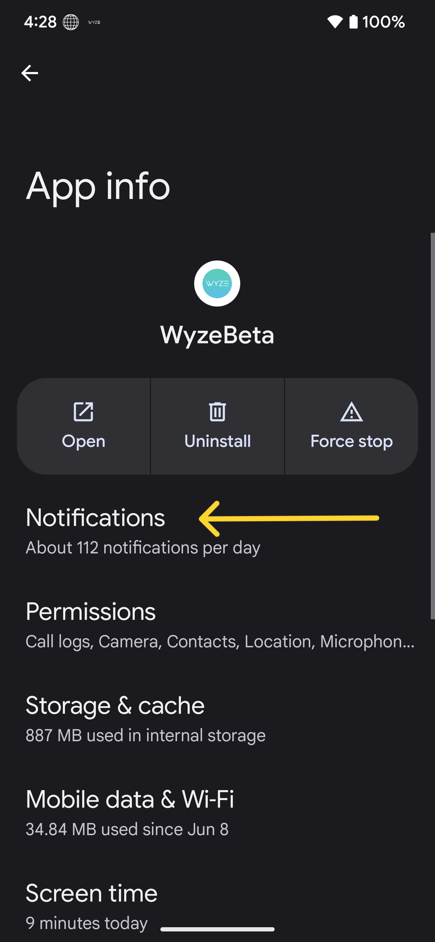

I have a Pixel 7 Pro and Pixel 6. To get notifications to appear be heard, make sure you do the following My Images are attached below each step:

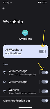

NOTE: you may see multiple WyzeMessages as in my image below. Each one corresponds to a Wyze Sound and another for the default app sound.

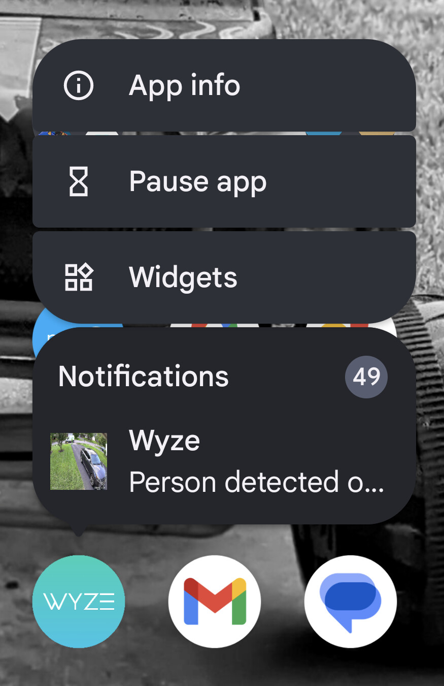

Shut down the Wyze App by swiping up on the main home screen the closing the Wyze App.
Long Press the Wyze App and select App Info
Select Notifications and make sure the toggles are on for notification
Select Wyze Messages and ensure you have Show Notifications and Default is selected.
Ensure your settings for Wyze Messages is not set to silent. My settings are below
