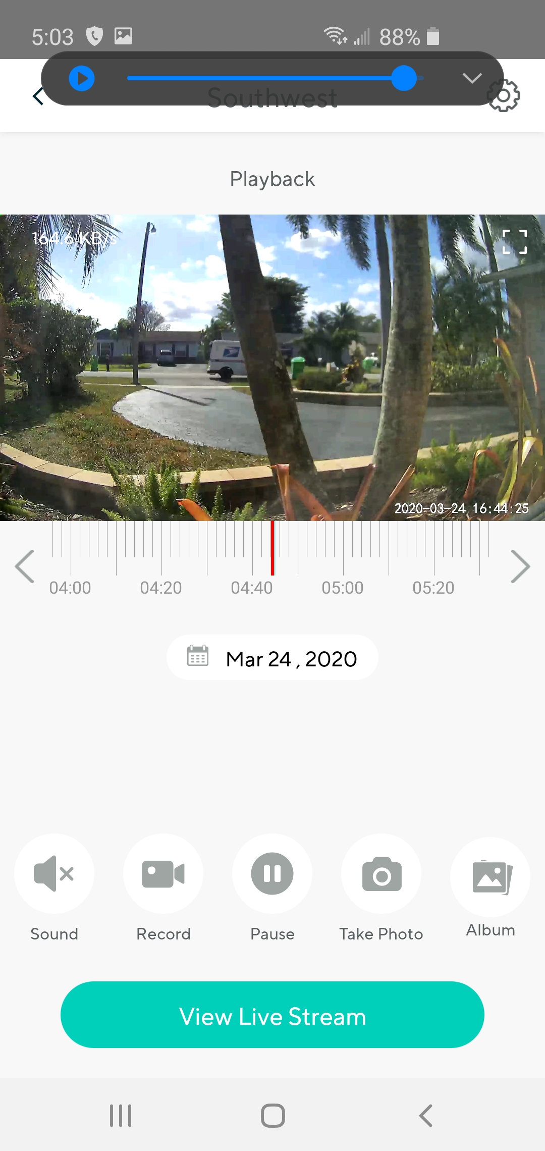

Yep, but this fixed it right away… Thx
I had the same problem. I just changed from “Continuous Recording” to “Record Events Only” , then back to Continuous.
